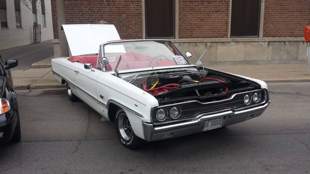

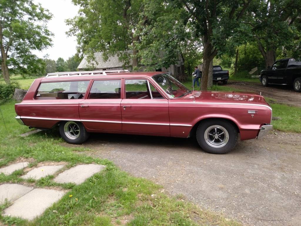

IMHO these tires are too tall for this car.. maybe one size down would have been a better appearance fit?

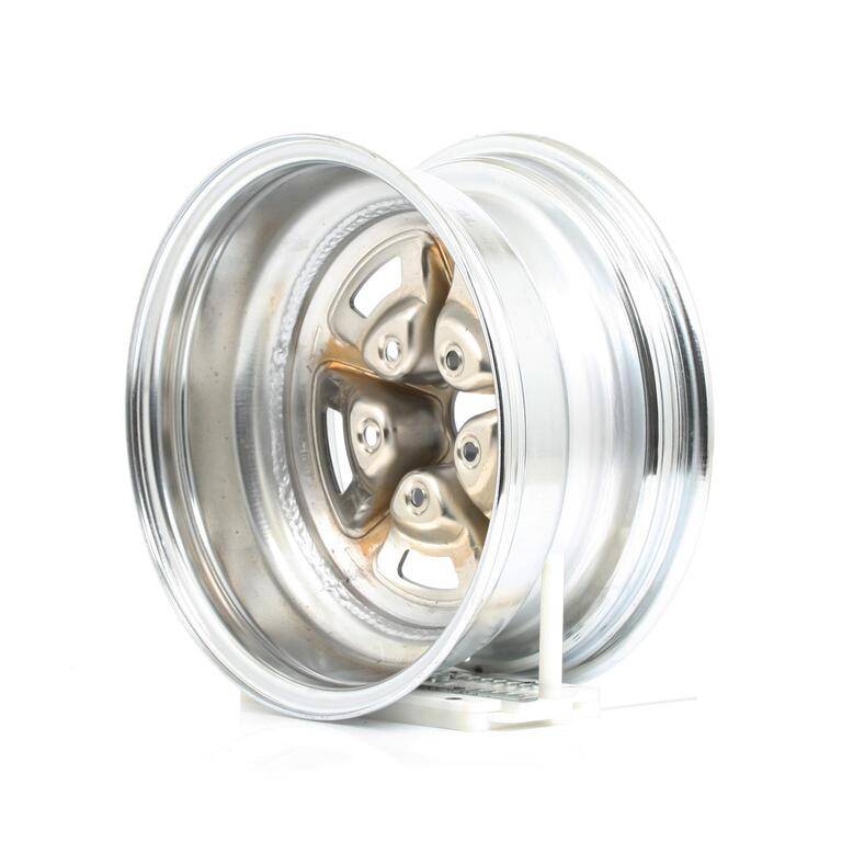

Just to make sure...BEFORE I buy...Ford, Mopar and AMC use the same Magnum 500 correct? All have 5 (hole) - 4.5" (center to center spacing) and the only difference would be the center caps correct? I'm talking about the repop 15" rims...not concerned about the original 14" wheels.

the repos will fit on mopars
Those look very much like mid-70s 14" Magnums, they typically have a silver/brushed spoke, not chrome.funny tat some of you are talking about the magnum wheel for earlier than 68's.
I have the chrome spokes and the brushed trim rings on my Polara...
they are a14"x6" rim.
What car would they have come from?
Those 235/70 tires aren't too tall, it's a visual thing due to being a blackwall. Either WW or RWL would break that up.IMHO these tires are too tall for this car.. maybe one size down would have been a better appearance fit?
These Magnum 500s don't have a hub register hole like a typical rim. They are stud-piloted, rather than typical factory rims that are hub-piloted. Which makes me re-think all the discussions I've read whether stud-piloting was 'good enough.' Apparently good enough for the factory engineers at the Big 3 and AMC, who all used some version of this wheel.Just to clarify, double check that the center hub (not the center trim cap) of the new wheels will fit the rear axle flange.
If you can't determine this for certain for Ford or AMC, then I would stick with Mopar only wheels.
Hope the input helps.
