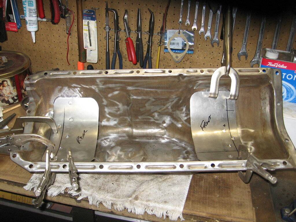

I did my own. This is a slant six pan but that doesn't matter.
I call them slosh plates for acceleration/deceleration to keep the front and rear seals from flooding.
This wasn't for racing or anything just something I wanted to try.
O.K.
Now that's what I call Down Right Helpful.
Those Photos are Exactly what I Need.
Once Again I Can Only Say THANK YOU!
A Bit of Fabrication and I'll be a Happy Chappy.
Kind Regards, Tony.M

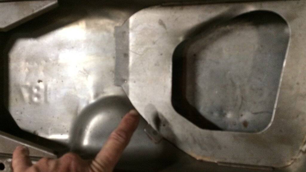

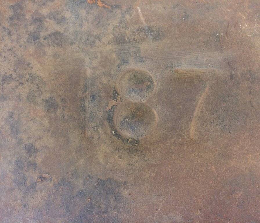

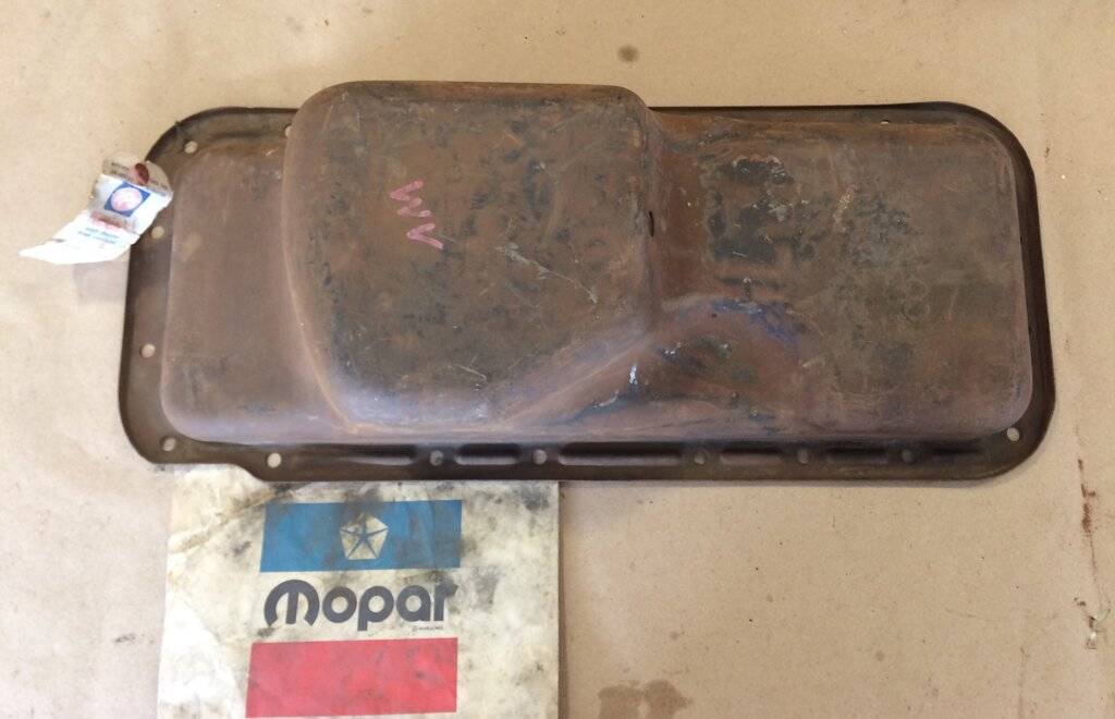

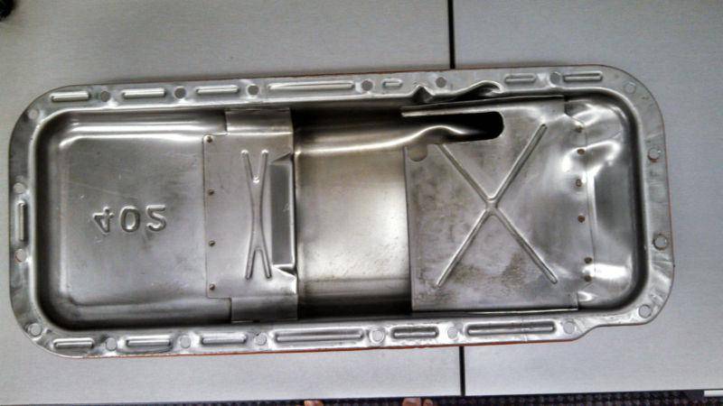

The # 187 HP factory baffled oil pan was on the build recipe for HP 440 engines in 1970.
