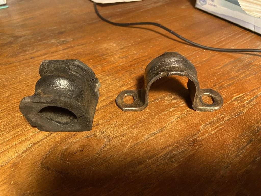

Thanks for the reply. The Camaro bushings are smooth - no flanges, and they are tall. We tried a set for a '70s Chevy van, looked good in the picture, much too large in person. The bracket is 1 3/8" wide by 1 1/2 tall inside measurements, holes are 2 3/4" center to center. Everything so far is too wide or unflanged. The B or E body turns up the same incorrect bushings as the C body; I'll call Moog tomorrow and see what they have to say.

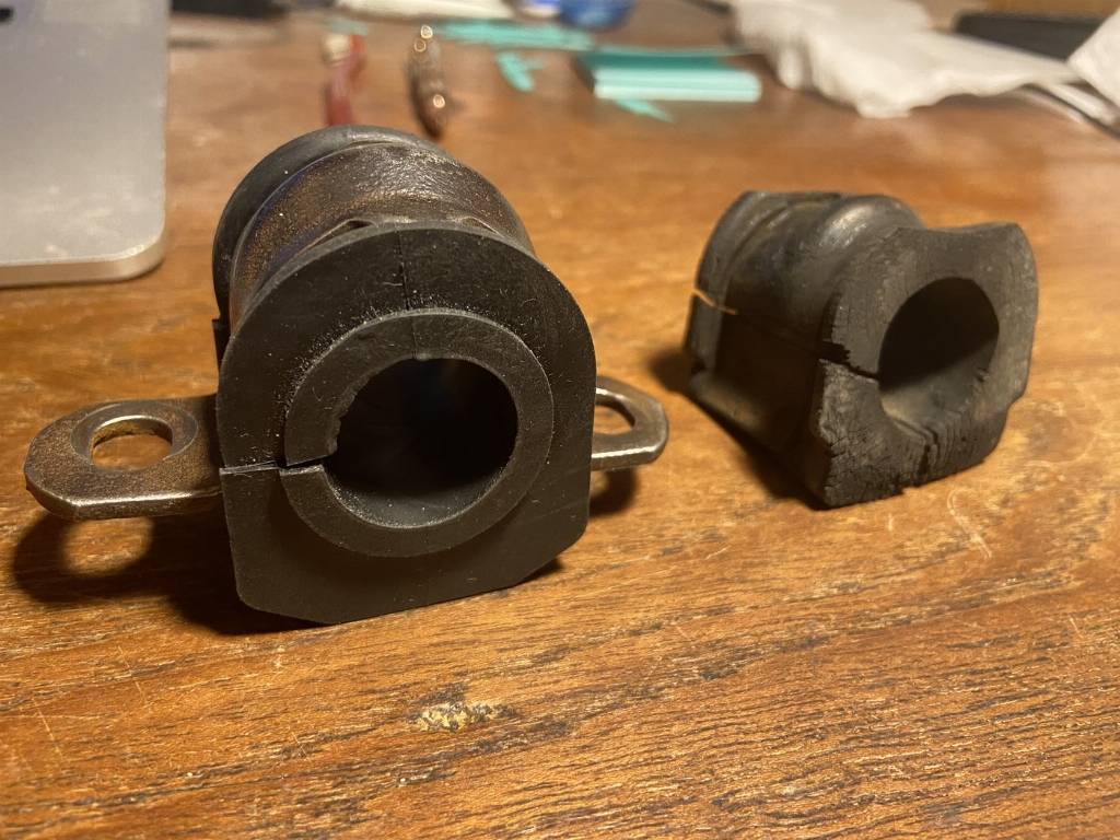

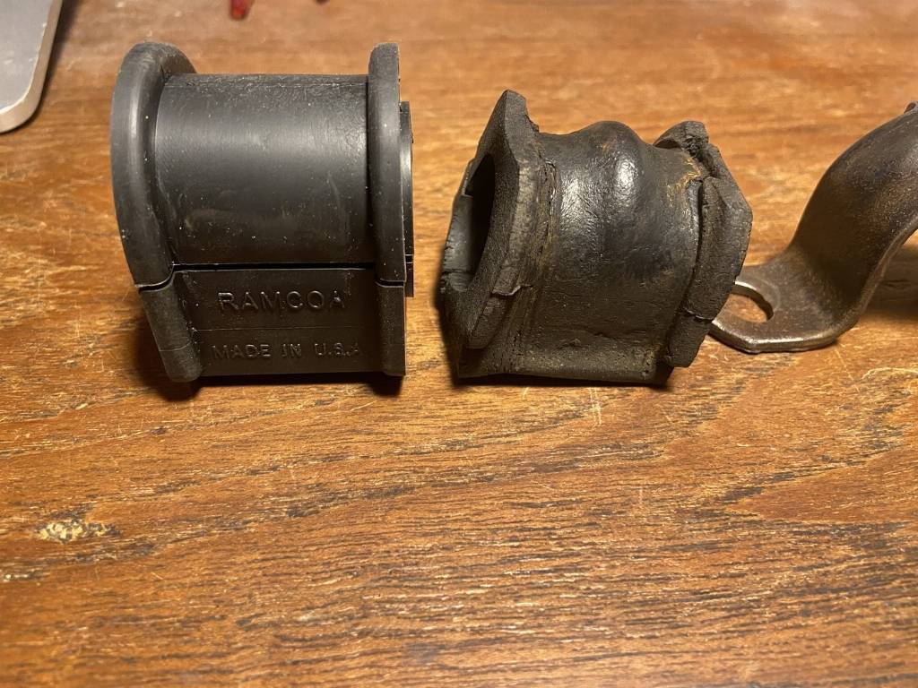

What I found was these:
Ironically later the day of the first post, I got an email from Rockauto about closeout items for the cars I have listed as mine. So these were for Fox Mustang with 1" sway bar, discounted to 11 bucks shipped, so I figured why not? I will trim the bottoms down to the raised flange area, maybe do some thinning around the U if necessary, and they should work. Nice quality rubber, very stiff.
Those also look like the '79 Firebird bushings, too. Except the ones I have are for a 1.25" bar. Perhaps the Firebird brackets would work too?
Good score!

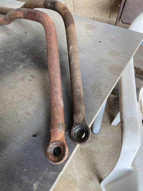

This is great info. I am replacing the original sedan sway bar with one from a '75 Town and Country 440 wagon, which also donated it's torsion bars. The difference in width of the two sway bars is apparent:
And should give a real improvement to the handling. Odd that Chrysler wouldn't service the bushings, (if I read that right) but no big deal, if the Mustang bushings don't work I can replace the whole bushing/bracket assemblies with aftermarket, although I prefer using the original parts wherever possible.
I saw those or a set like them. Can you confirm if they are U shaped inside the square flanges, or are they square all around and require a square mounting bracket?
They are square all around and fit the fixed frame i pictured earlier in this post. The kit came with new nuts, washers and bushings for both ends. I had to cut the bottom flange and drill bolt holes as the factory links had welded cages.
