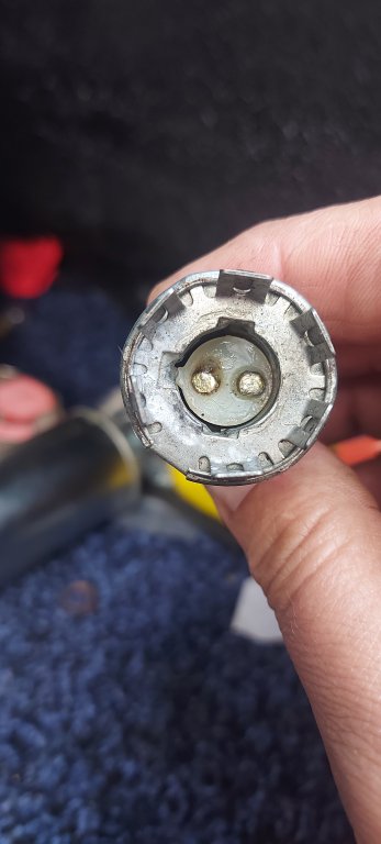

I cleaned it sprayed and the damn bulb still won't come back on . I have power to it. What the hell. Maybe I should just change it

the contacts look pretty smashed or ground down. have you tried installing the bulb and pushing the wires in from the back of the housing? sometimes the spring inside will get compressed and not push the contacts up to meet the bulb.
I'm gonna try that too. Thanks . They were working intermittently, now I have nothing . I took bulb out to inspect it now I can't get it to work .

Springs are working . Just can't seem to get it right . I'll fiddle more . Was always touchy since I've had the car . Now damn thing won't light
I've had trouble with bad ground connections between the socket and the housing. What happens if you add a jumper wire from the socket body to good ground somewhere?
If the spring- socket is holding in the light's housing, the grounding is possibly OK. Might be the ground path from the housing, and further downstream, that is the problem.
Using a small hoseclamp (or even a ziptie) to hold the bare end of a separate ground wire onto the socket is a durable (albeit hillbilly) way to improve the grounds. Smear some anti-corrosive on it, and make sure the other end of the wire is well-grounded also.
