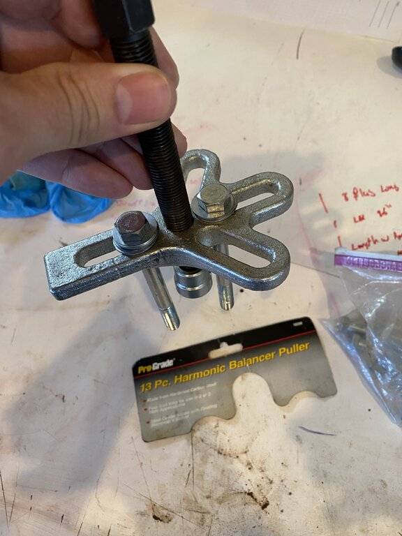

Steering wheel puller is pretty simple and universal. Harbor freight, or if you have an O’reilys parts store (probably others as well) have a tool borrow program. You pay the deposit (price of tool) and use it. Return it and they refund. If you like it and want to keep it they just keep your deposit. I think I bought two different pullers that way. Decent price and decent quality, plus they were Brand new.

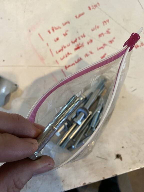

Here is what I used for the steering wheel
They come with or you can use a variety of different bolts for different size holes.
