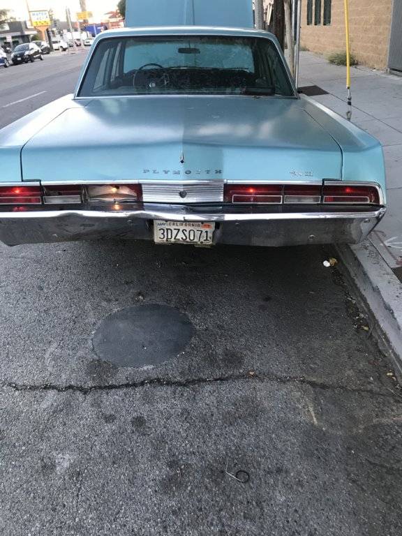

So the car will be completely off with switch off and one side of the tail lights stay on.. is it the cam signal that needs to be replaced or harness..
Because the ignition is off, the power source is coming from your brake light switch. Check for a defective switch first.
Simple test for this, you probably have the turn switch engaged, place it in the parked position and both brake lights will probably stay on assuming they both work, sure sign of a stuck brake light switch.

Will do. I bought the cam signal just in case..
Can you pull the pedal back towards you at all? If so, you need to pull it back and see if the lights go out while you do. The switch is either out of adjustment or stuck in the on position.
Will try in a few but I was looking for the brake line switch couldn’t find it

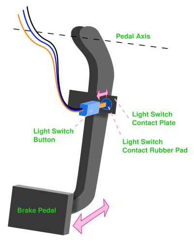

Here's my 2-cents. The brake light switch, above the brake pedal, which will contact the "arm" of the brake pedal is most likely your problem like 300rag said. It's usually white, about 2" long and "way up in there" on a bracket near the brake pedal "arm" with 2 or 3 wires running to it. It is almost for sure the reason your battery keeps going dead.
The switch is a button which gets pushed by the brake pedal arm. The button is always being pushed when your foot is not on the brake pedal & your brake lights stay off. When you push the brake pedal, the pedal's "arm" moves & releases the button, which turns on the brake lights.
Most likely fix --> Adjust the brake switch. You will see that the brake switch itself is threaded & held onto its bracket with a cheap looking aluminum nut. If you loosen that cheap nut, you can adjust the brake light switch forward/backward as needed, then re-tighten the nut. You want to brake switch button to "almost be released" so that the brake lights will come on even if you just tap the brakes. HOPE THIS HELPS!
