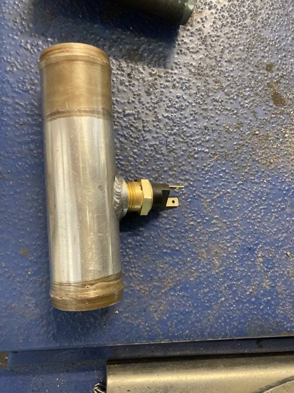

I want to mount the sender for the dashboard hot/cold light in a radiator hose using a metal sleeve (see photo). Will engine coolant adequately complete the electric circuit, or must the sender be mounted in a metal part such as the block, water pump housing, etc.? Temperature sender for the Holley Sniper EFI is where this sender used to go, so I need an alternate location.
The sender mush be grounded for it to complete the electrical circuit that turns the dash idiot lights on or off. So solder a wire to your sleeve (if it's brass) or figure something else out (if it's aluminum, can't quite tell), and run it to a ground....solved.

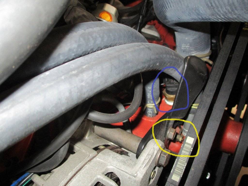

Does your setup have the small plug on the front of the housing (circled in yellow). That's where I "power" an aftermarket gage, and retaining the "cold/hot" sender in the traditional location.
Weld a tab on your tube and screw a ground wire to it. Or make the tab the correct thickness and width and plug a spade terminal to the tab.
The water pump housing is an aftermarket part. I will have to look. Appreciate the idea.

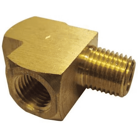

This smaller, forward-facing bung is sized for the standard 1/8 NPT temp sender. Other housings have it facing up, where the AC sump would nearly be touching the housing, thus the forward facing bung in some housing for AC cars.
