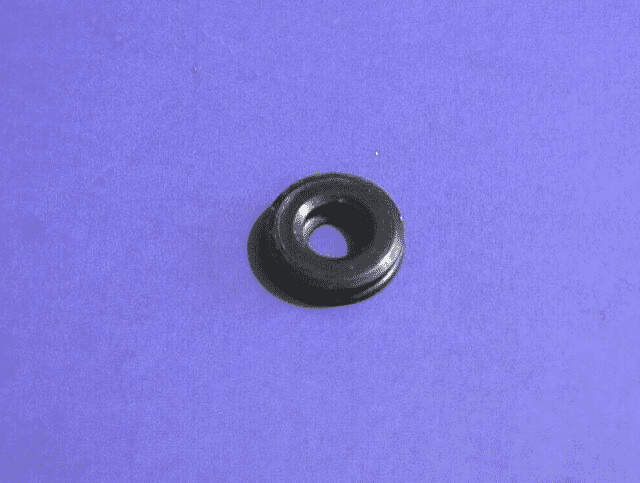

The seal looks like this. It is the same seal as the one used in '66 up where the throttle linkage goes into the valve body, but in this case, the seal goes in the case.
