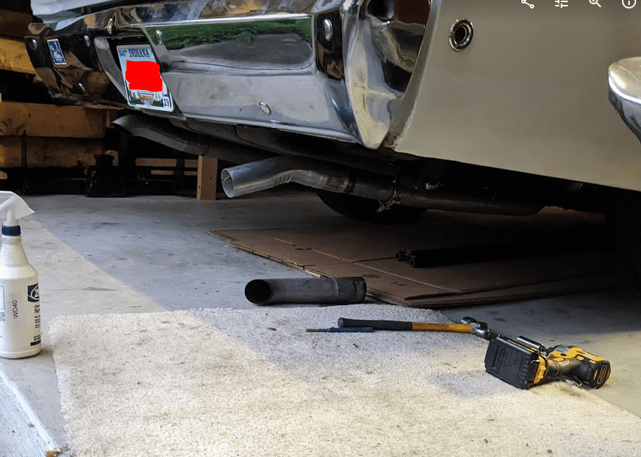

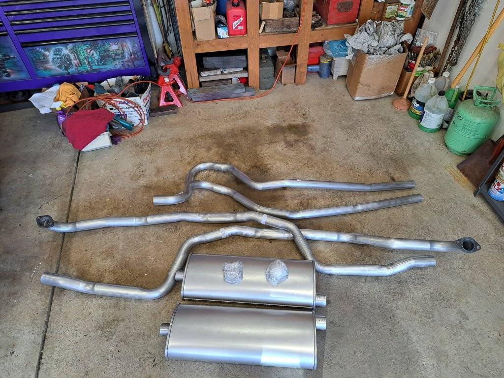

Here is some background for the question. The original single exhaust on Buttercup, my 1972 NYB, was replaced by a dual setup under prior ownership. The car had a small exhaust leak that @71Polara383 fixed, but it has come back and gotten worse over time -- so I decided to replace the exhaust. I went with duals, on the recommendation of @david hill
In an attempt to be "correct" (despite the fact that my car originally came with a single exhaust), I ordered my duals from Waldron. The pipes arrived a few weeks ago, and they look great -- but the tips are straight. When I inquired, I was told by Ruth (my always helpful and cheerful contact there) that "Chrysler did not put turn downs in the tailpipes for 1972 models. We built your tailpipes using out IPC patterns & bend cards which are patterned off of Chrysler tailpipes; Chrysler’s part # for the driver side tailpipe is 3466053 & on the passenger side it is 3466054."
Waldron has always been correct in my experience with them (3 systems thus far, this is #4) but I am puzzled, as some of the original-looking cars in this thread seem to have turn downs (see here as an example). Of course, there is no way for me to know if those cars that look original, truly are. Looking at the 1972 parts manual (Section 11) and at the Chrysler brochures (Fuselage.de and Hamtramck Historical), I see no photo of the tail pipes -- they are well hidden by the rear bumper and lower quarters. Still, on the two 1972 Chryslers that I have seen with what seemed to be the OEM single exhaust, there was a turndown. Those are CL23M2C279105 (a GY4 Newport Royal 2dr now owned by @XavierHarvey ) and CS43T2C306134

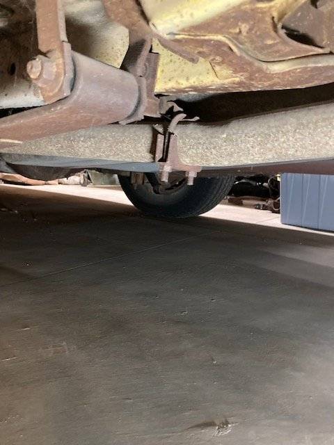

I do have a 1973 2 door Imperial with some 33K miles on it and I am pretty sure it has a single exhaust system that I will go out and look at a little later in the day but those cars from the factory came with single exhaust systems and the last piece in the exhaust system was the resonator that always has the turn down at the end as I recall. So if Waldron's is talking about the tailpipe, then it was probably just cut off straight but when the resonator is added, it would have the turn down that you can see from some angles and depending on your level of sight. I don't believe 1972 and up Chrysler New Yorkers and Imperials from the factory ever came with dual exhaust systems since there was no 440HP engine option and I see no good reason to go with them unless you really value top end performance. Duals just add more complexity and service cost when the time comes.

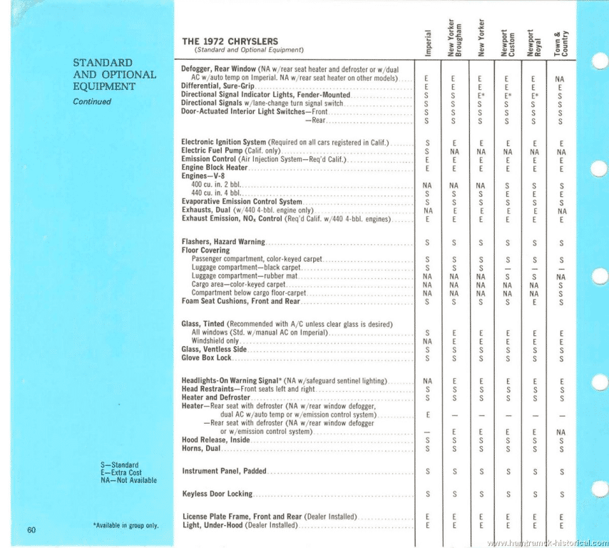

dual exhaust was an option on 72 440 Chryslers - but not available on Imperials & Town and Country
it bumped the net hp up to 245 over the single exhaust 440's 225 net hp.
afaik these were not TNT U codes
Chrysler New Yorker Brougham 4-Door Hardtop 440 V-8 TorqueFlite (aut. 3) , model year 1972, version for North America U.S.:
Chrysler New Yorker 2-Door Hardtop 440 V-8 TorqueFlite (dual exhaust) (aut. 3) , model year 1972, version for North America U.S.:
Well, I learned something new. I am surprised Chrysler would have done that on a non-HP car...............thanks for the information. When Chrysler started making the front of the 72s and especially the 73s more square to lean into the formal look to come later, I pretty much lost interest in the 72s and up - however they did have even more sumptuous interiors and lower noise levels than even the improved 71s which was worth something to me at least. Maybe if @ayilar wants the new dual exhaust more quiet, maybe he could add a resonator on each end that should/would have the correct turn down like was done on my 1970 Cuda 6 pack from the factory.
It also surprises me that they would make the dual exhaust available on a New Yorker but not on the Town & Country models.

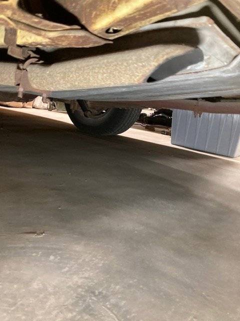

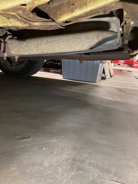

The exhaust tail pipes in question are in the photo below. At the same time @73 New Yorker, ( Randy ), had dropped off his1973 New Yorker for repairs. The Waldron tail pipes ordered were a dimensional exact match to the tailpipes on his Randy's car as seen in photos 2 &3. Since the there are the same in length a short extension pipe will be needed w/ the appropriate turn down. Have any members had this experience before and where did you get the needed pipes.

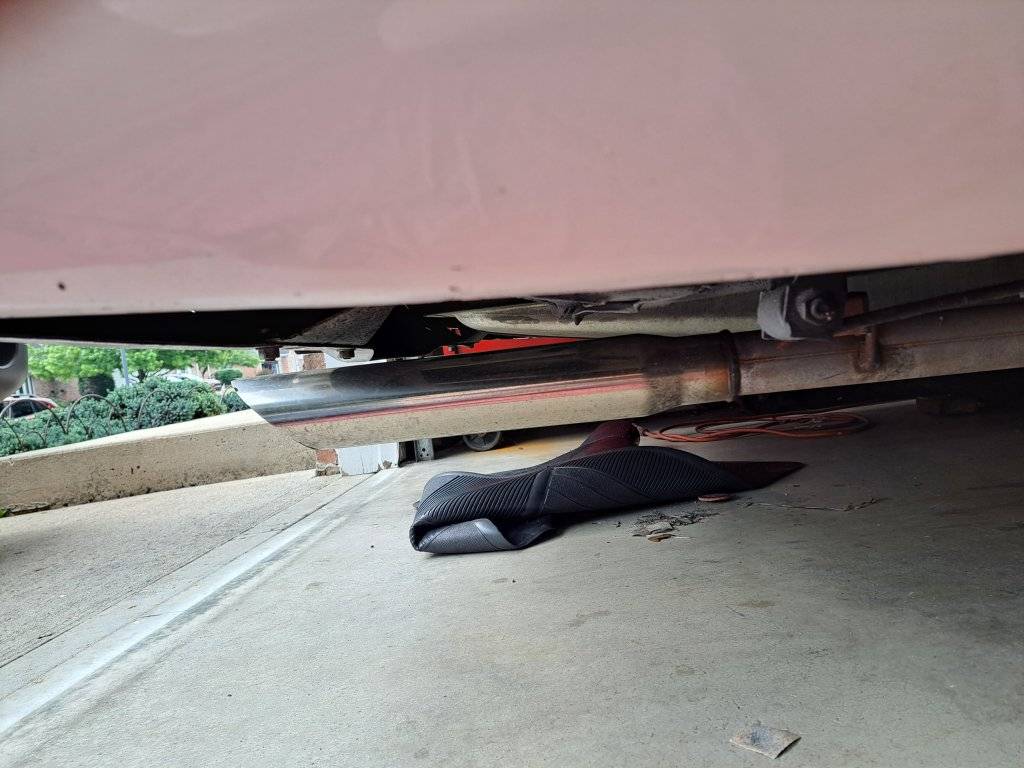

I just went out into my garage where my 1971 440HP New Yorker is sitting and took a photo of one of its original exhaust pipe tips (the car only has an original 38K miles on it and this pipe shown below is its original one). I would expect the 72 models with dual exhaust would have looked the same. The Waldron end is a start but it will need to be modified somewhat to get it to look as original. The original pipe shown in the photos would need to be bent upward just a little to make the end sit horizontal just below the valence and the tapered outlet as it sits now would need to be rounded with a suitable grinder/sander to round/scallop it out more. If the Waldron tailpipe is not long enough maybe a muffler shop would be able to add a short length that looks like the original one in the photos below. Maybe if someone has a 1972 model with its original dual exhaust system they could verify what I am showing below would be the same for the 1972 models.
I also have a set of dual exhaust pipes for one of my 1971 Chrysler 300s with the 440 HP engine just sent on its way to me from Waldrons and they should be here in a matter of a few days now, so it looks like I will have some work to do as well.

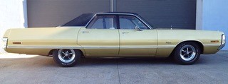

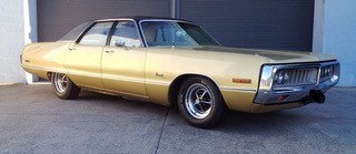

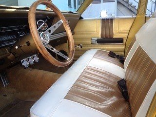

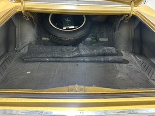

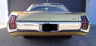

Hey Guys,
been a very long time since I posted on here, I just bought ANOTHER C Body, this time a pretty neat 72 Newport Royal, not many options, not even A/C! Its been in Australia for about 8-10years. I was hunting around the web and found the original video of it when it was for sale in the USA!
The Edelbrock carby is junk as its flooding the motor on & off, 3rd set of plugs already!!, new carpets ordered and I am hunting for a new vinyl top as this one is really badly made, who do you guys recommend for a quality replacement?

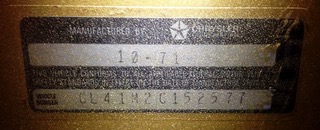

Thank you for posting about CL41M2C152577

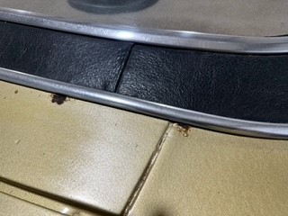

i ordered the vinyl top for Buttercup, my 1972 NYB, from SMS. It is perfect. This said, @73Coupe will tell you he had to wait a loooong time to get the same correct top for his (similar) ‘73.
@Oz Sport Fury -- I don't see the V1X code for the black vinyl top on your Newport Royal (it has to be a Royal, as the A1Y5 interior is unique to that line). The third line from bottom shows GY8, so the roof was originally painted in the main color (no vinyl top). Yet, it has the moldings for a vinyl top.
Perhaps @69CoronetRT can chime in?
