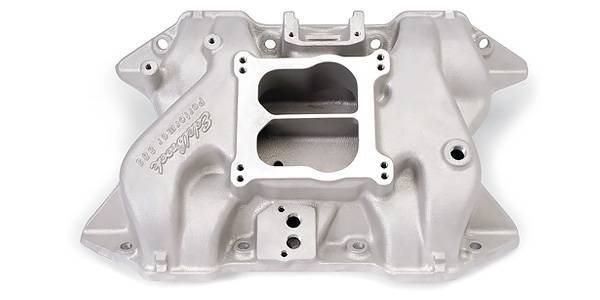

Great looking car. How are you doing with a single plane intake on the street? I would think you are loosing plenty of bottom end torque.
To be honest, this is my first classic car that I have worked on. This is the type of feed back I need. What would be a better option? I see this original Mopar single plane M1 sells for $500 or more on Ebay. I could always get something else?
Good idea on selling the single plane M1, It is a great intake but it is designed for high RPM use.
Edelbrock Performer is a good street performance intake, it is a dual plane and looks close to stock with more performance and less weight.
If you can't get a performer a stock iron intake from 72 up is very good design. You will need to spend time cleaning it up and blocking off some sensor ports, EGR etc....
So finding a good Performer or just buy new will save a bunch of time.

What about something like this?
CHRYSLER Weiand 8008WND Weiand Action Plus Intake Manifolds | Summit Racing
great choice, good price. I was going to suggest a Weiand as another good choice.
Good thing with the Weiand is the square bore flange for your carb.

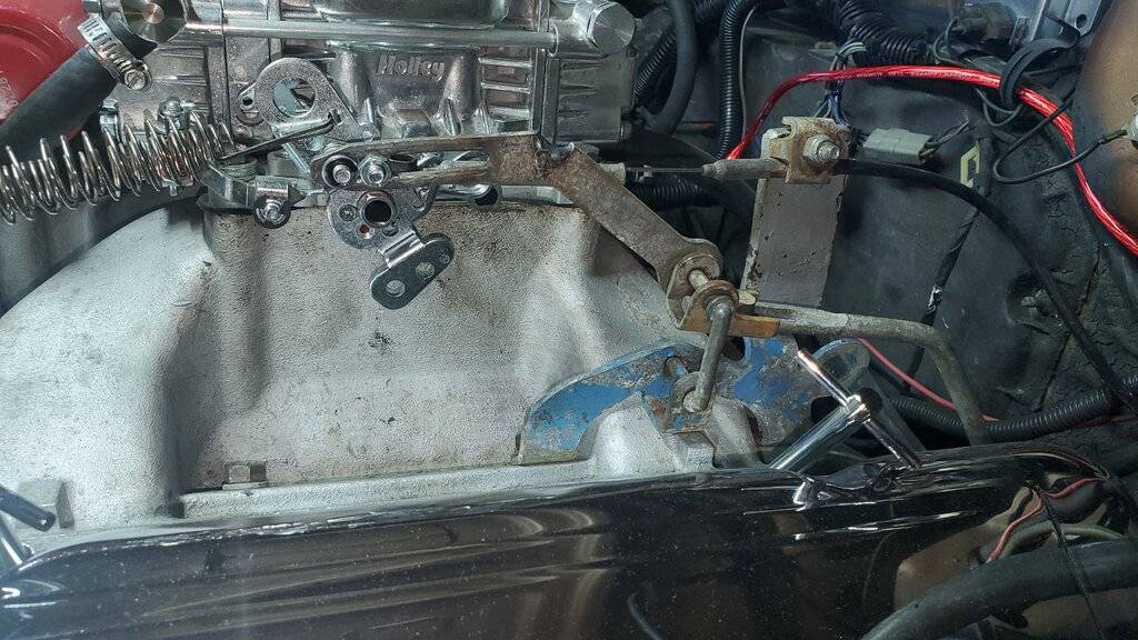

Ok I will go with that, only thing I need to figure out is how to fix this mess the guy before me made. As far as the throttle and kickdown. As you can see, they made part of it themselves. Thoughts?
