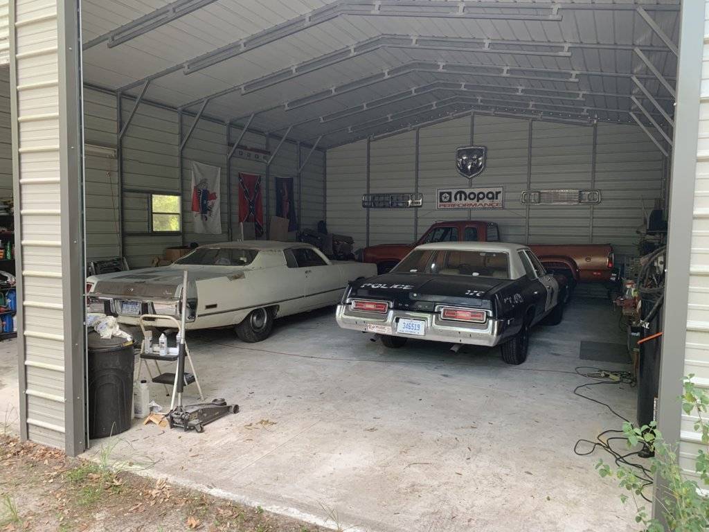

I spy you wife's truck stuck way back in the shop, it's not going to get any love or road time back there.:poke:
No it is not, but that’s ok.... Newport is too big to work on back there, and the dually hasn’t been going anywhere lately. The dollies make it easy to get it out though however, surprisingly.

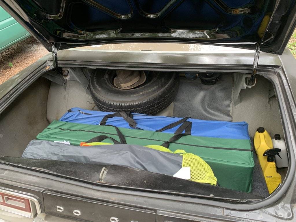

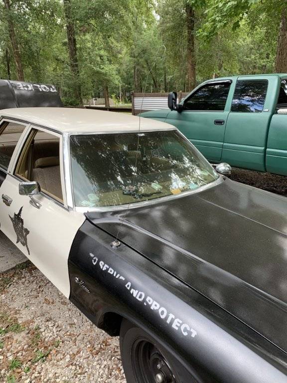

We ordered a new canopy and chairs for Carlisle. Got em un-boxed and shoved in the trunk. Also made up a new blumo correct antenna again! I made one for Carlisle in ‘17, but it blew off in GA lol. Might have to take it off and put it back on once we get there this go around. Also noticed I’m missing one of my plastic license place push in nuts. Luckily the frame and plate held on to the 2 lower ones. Don’t want to loose that expensive plate!
