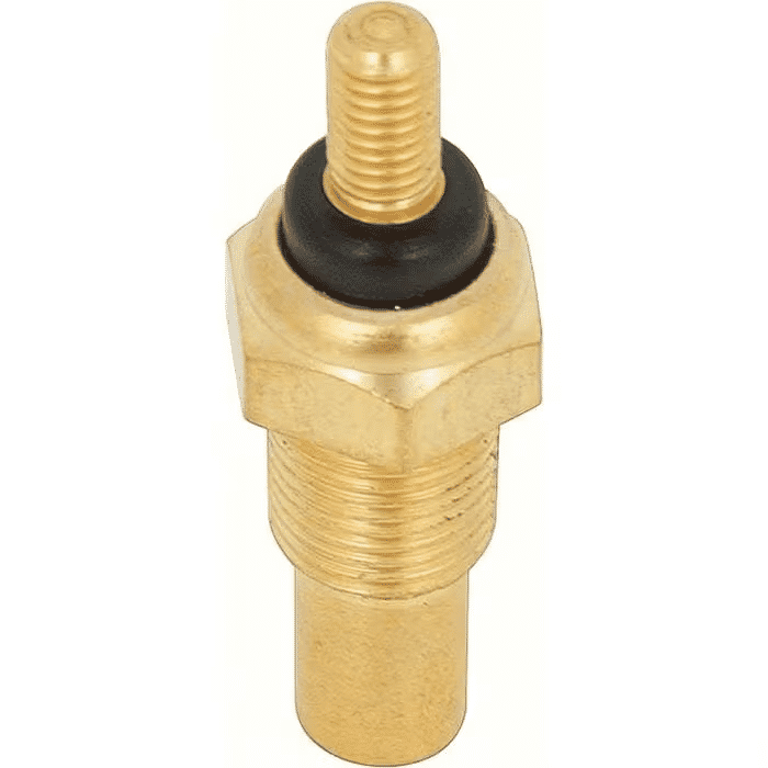

If the sending unit looks like this, it's for a gauge.

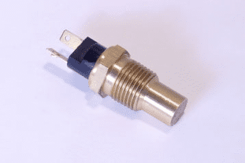

If it looks like this, it's for an idiot light.
Here's the thing... A sender for the light is larger in diameter and will not fit in the hole for a gauge sender. It also has 2 spade connections rather than a single screw.

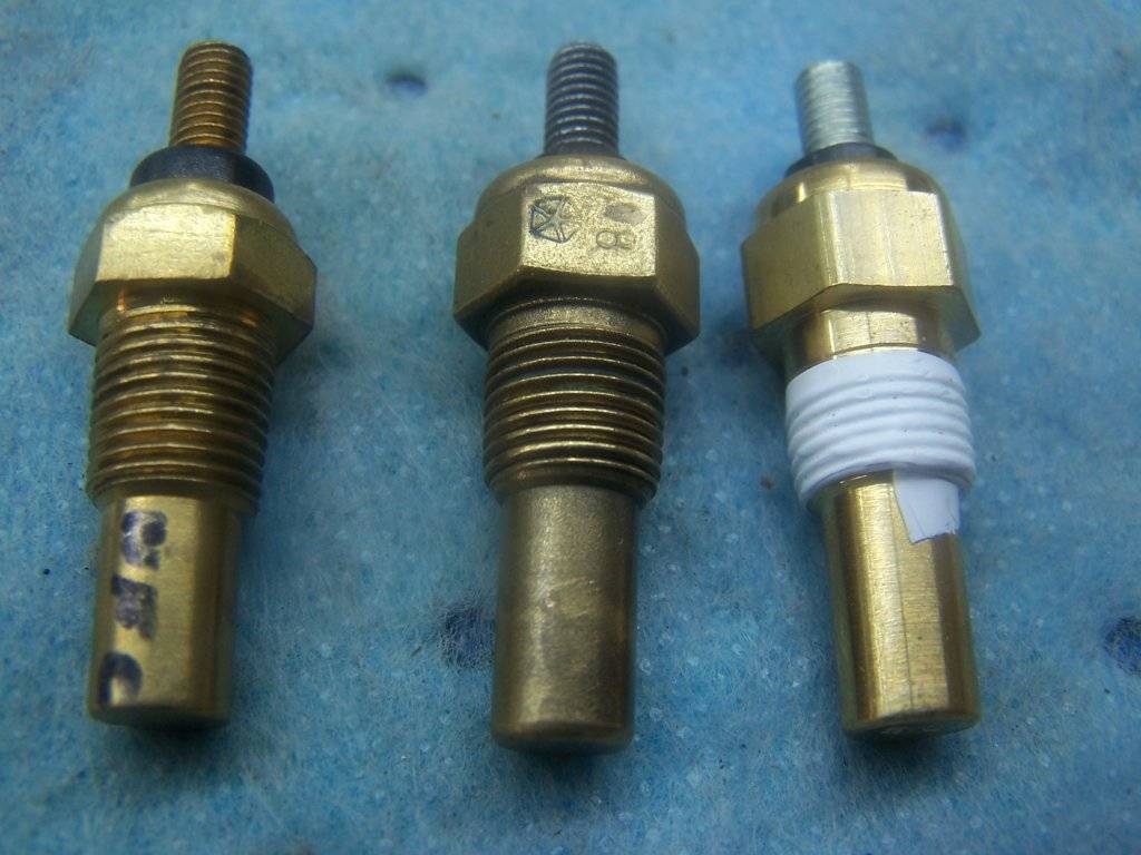

I have run into the same problem a while back. I believe the parts stores are giving out the wrong part number in many cases. What I recall is they have a couple of part numbers that cross over to the correct one. Although they look the same, one has a cold reading of 500 ohms and the other 250 ohms. The correct part has the 250 ohm reading at 70 degrees F. I took my ohm meter to Napa and tested both of their crossover numbers to get the right one. I ended up buying the TS17 sender that has the 250 ohm reading. I don't remember what the wrong part number was. Here is a picture of one wrong part and two correct parts. Although they look pretty much the same the wrong one on the left (500 ohm) has a shorter probe and a few more threads than the TS17. Ask for the TS17 or take your ohm meter along.
Awsome info!! I am not crazy after all. Well maybe a little bit! I will take a meter to the store and ohm the part out before I buy it. Thanks for clearing up the " it looks the same " but its not the same problem I was having!
If you ask for a TS17 you should get the 250 ohm sender. I don't know the application of 500 ohm one. Think maybe Ford.
