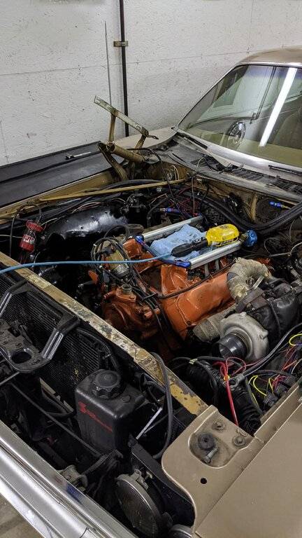

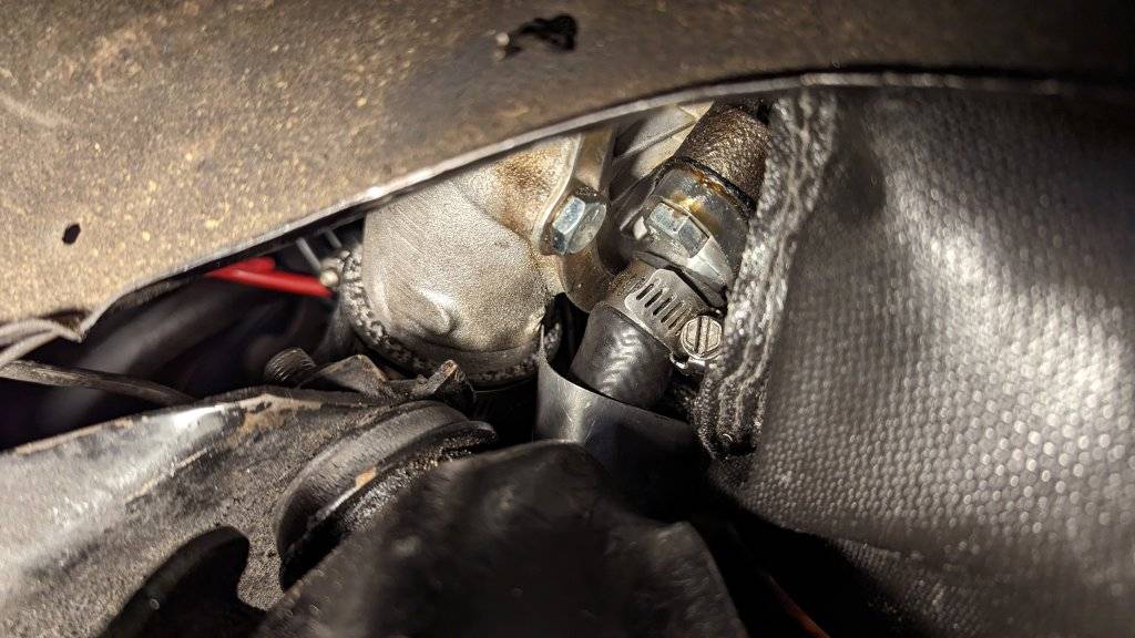

Whew. I'm apparently getting old. I was sore and tired after the past weekend and all I did was get the engine in and bolted to the trans!
All the bolts for the exhaust worked out fine. I had a heck of a time getting the trans to slide back to give me room to do the engine in. I tried it redneck style first just angling the engine to slide the converter hub into the crank, no go.

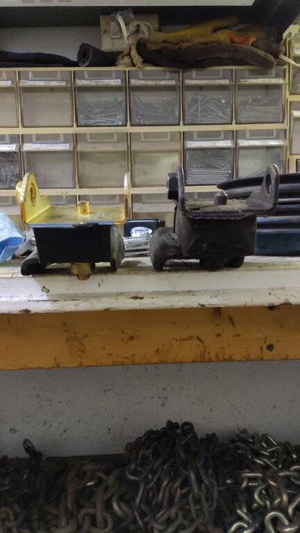

I also had bought schaumacher Magnum mounts years ago but never had the chance to put them in. I didn't test them in the saddles before hand and I couldn't get them down into the saddles enough.
So it came back up and out.
Turns out one wasn't exactly the same, it was a little short, that's why it wouldn't come down enough for the bolt hole. So I made a small shim to bolt into it.
Back in it goes, trans shimmied a little bit back, mounts actually line up!
And then I spent 2 hours trying to get the stupid trans to mate up. I didn't have the car jacked up so I couldn't get under, finally jacked it up and just couldn't get it to wiggle in and seat the dowels. Finally got it started but truth be told I did have to draw it tight carefully with the bolts. They drew up very easy luckily.
Starter went back in easy. About that time I noticed that my speedo cable didn't have a ton of slack...I bet that has something to do with why I couldn't get the trans back...I didn't take that loose
Anyway, at least it's all buttoned up underneath including the flex plate. Just a bunch of stuff up top yet.
