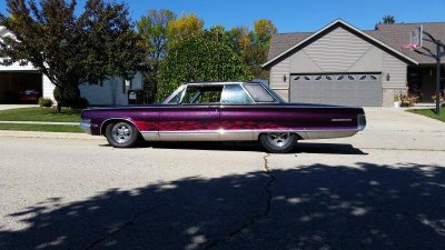

The New Yorker had a slight make over.....
Nice work! What did you use for coil-overs and the ladder bar setup?
The ladder bars are Chassis Engineering double adjustable "ladder links". The coil overs are QA1 street shocks. It rides nice. At least as nice as stock, if not nicer. But because ladder bars are a solid mount and I did not use urethane bushings, I opted for the heim joints, it does make some noise from time to time. Nothing you can't live with and its so faint that if you just turn the radio on, you can't hear it.

a 512" stroker with a good set of Indy heads may be the ticket! Either way you've done a nice job on that rear suspension setup so I'm certain she'll hookup! keep us posted

Heads, cam and intake. Converter and gears too along with some tires that hook. A good combination is what you need, not necessarily alot of horsepower. I just shaved over 100 pounds out of this car with the ladder bar set up and wheels. It will probably lose another 100 pounds or more this winter. That makes a noticeable difference too. There is a Coronet in the my area that runs 10.80s with a very mild 440 with 906 casting heads and an off the shelf .509 purple cam....and it weighs over 3800 pounds without the driver. The car is set up right and it runs good. He is a blue bottle away from single digits.
