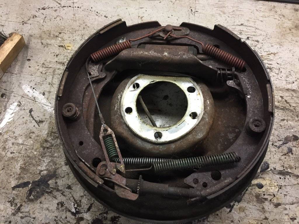

Wow those parts cleaned up nice!!
Did you dilute the AM at all?
How long did it soak?

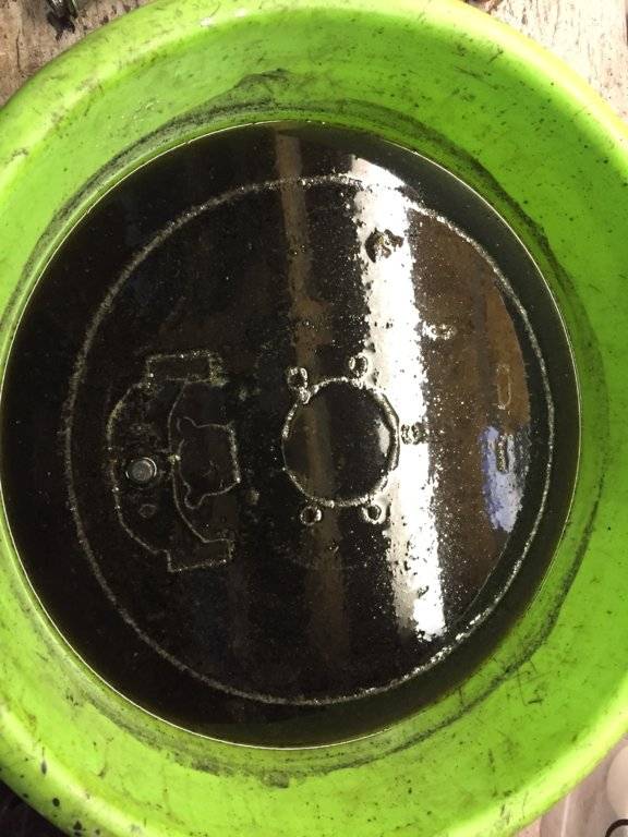

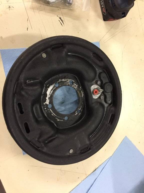

Here is one of the backing plates soaked and cleaned with AM
It created a really interesting film in the tub I used.
the backing plate is still in the tub...

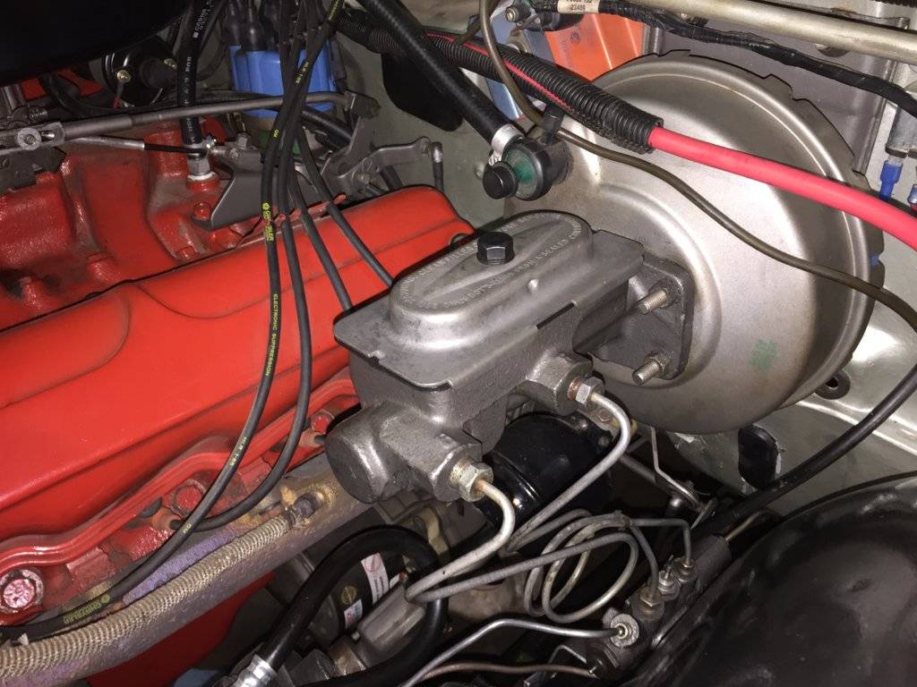

I was lucky that when I bought the car back in 2013 there was an NOS disc brake C body dual M/C for disc brakes with the car.
The brake lines from the Newport were in most excellent condition and cleaned up very well along with the OEM Newport distribution block
I only had to remake one front brake line
I also had thought about reusing the Booster from the 73 but quickly saw because of the shift linkage as mentioned in numerous threads that it can't be used.

I wanted to mention that even though the AM turned black, it is still important that it doesn't get on you cause it will continue to work for some time.
Once you want to dispose of it.
mix up a bucket of Laundry soda and water and slowly pour the AM mud into the soda water to neutralize it so you an dispose of it safely.

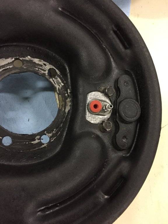

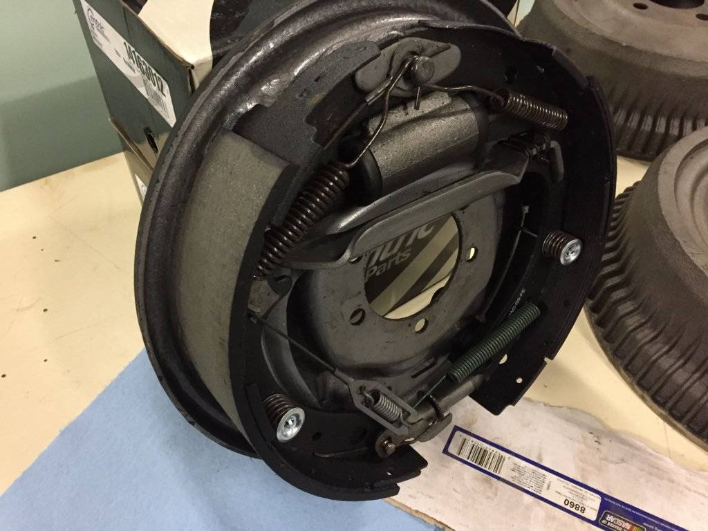

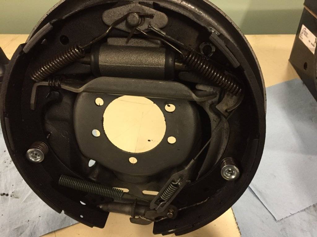

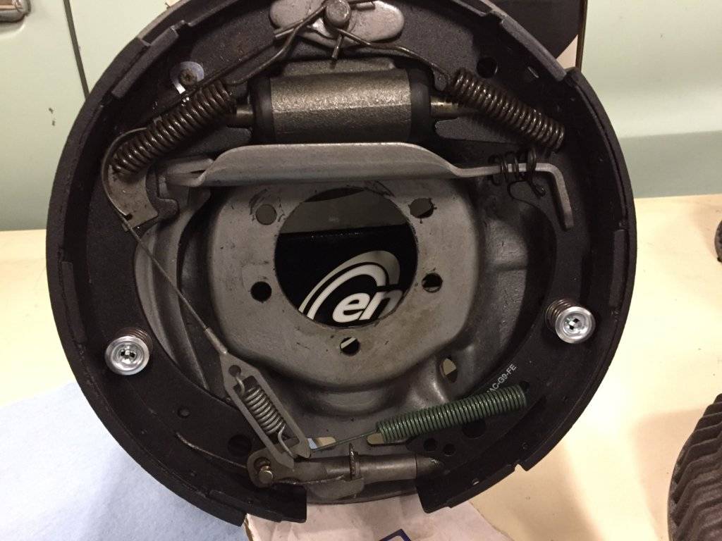

I tackled the rear brakes on my own tonight. nothing special really, remove the brake line, remove the e-brake cable and then pop the axle out after removing the retaining nuts of course!:lol:
Reverse the process adding the 2 1/2" pre-assembled backing plates .
Torque to spec, adjust the shoes to the drums, bleed brakes and it's ready for atest run..

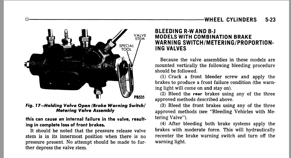

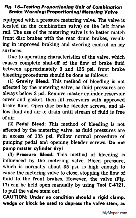

So an update. Back brakes are done but having a heck of a time bleeding the brakes with the stock 73 distribution/proportioning valve.
I found the technique on how to do it but I decided not to chance the NOS M/C I have and ordered a new 73 M/C.
It shows a special tool to keep the valve in place while bleeding the brakes...
Once that arrives then I'll move forward to bleed the brakes again.

I suspected the OEM distribution block/proportioning valve was stuck or tripped.
I hooked up my test light to the grounding pin and sure enough it lit up.
Definitely an indication that the system is not bled totally yet or the block is stuck.
I had my lovely wife assist me with bleeding the brakes again.
I let the front caliper loose and bled the rears.
Re-bled the fronts after the rears
Light was still on so I cautiously pumped the brake pedal then viola! the light she went out!

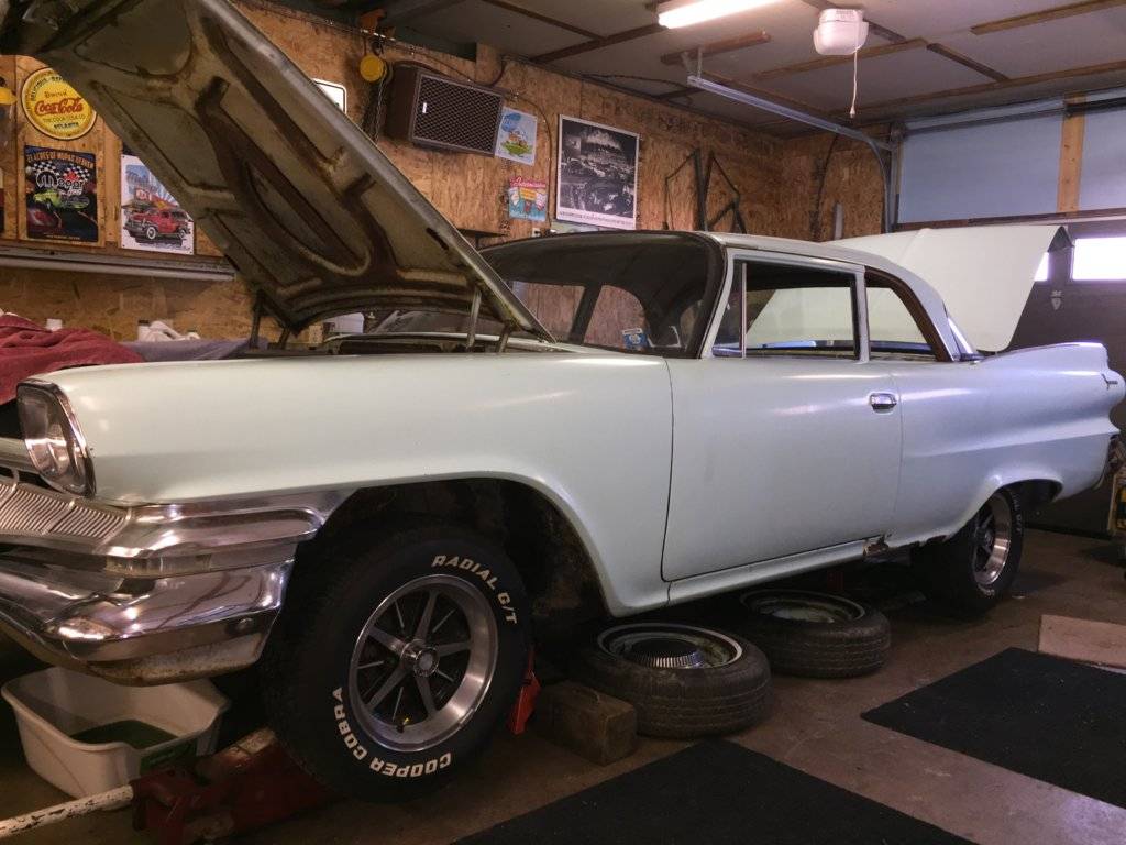

I torqued the wheels on and down on the ground and took Trixie out for a test drive.
Having the new brakes on all fours will take time to break in but so far I am happy with the results.:thumbsup:
I checked the rotor/hub temps with a pyrometer and both were at 105f' after the test drive
the pedal feels like it takes strong affect about half way through the pedal travel but this did this with the drum brakes as well.
Nice and steady braking, no grabbing anymore plus the vibration that has haunted me since buying the car is virtually gone.
