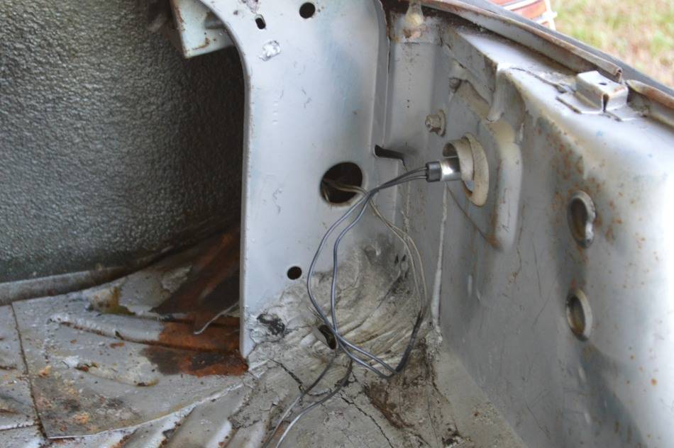

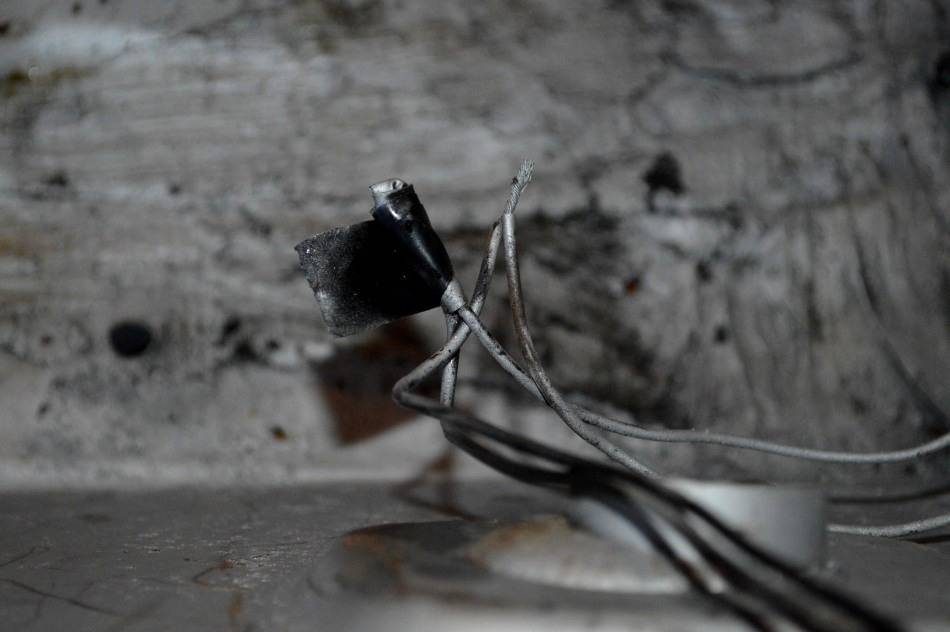

A week or so back I had a little time and a replacement tail light socket for the one rotted out in the trunk. Decided to swap it out and do it right, vs. the last person's repair which consisted of wires twisted together and wrapped with a couple turns of electrical tape. That's fine if you break down on the highway but it really needs to be addressed soon after. Photos attached of before/after or how not to/how to.
So aside from the fact that the replacement socket isn't exactly correct (works but too short - doesn't illuminate lens fully), it works and now there is light where there was darkness. How do I know, you ask? Well, foolishly I went and turned on the headlight switch and sure enough - the lights came on. And stayed on, even after I shut the switch off. Yep, the @#&*%$!! switch is roached now as well. Not a big deal except it requires major dash surgery to get to it with the A/C vent directly below and blocking it. That's upside-down, no room to work-surgery. Since I need to pull the gauge cluster anyhow, I'm hoping I can gain access then, despite the wiper switch being between. I mean, c'mon! EVERYtime I fix something, this car repays me with something worse to fix.

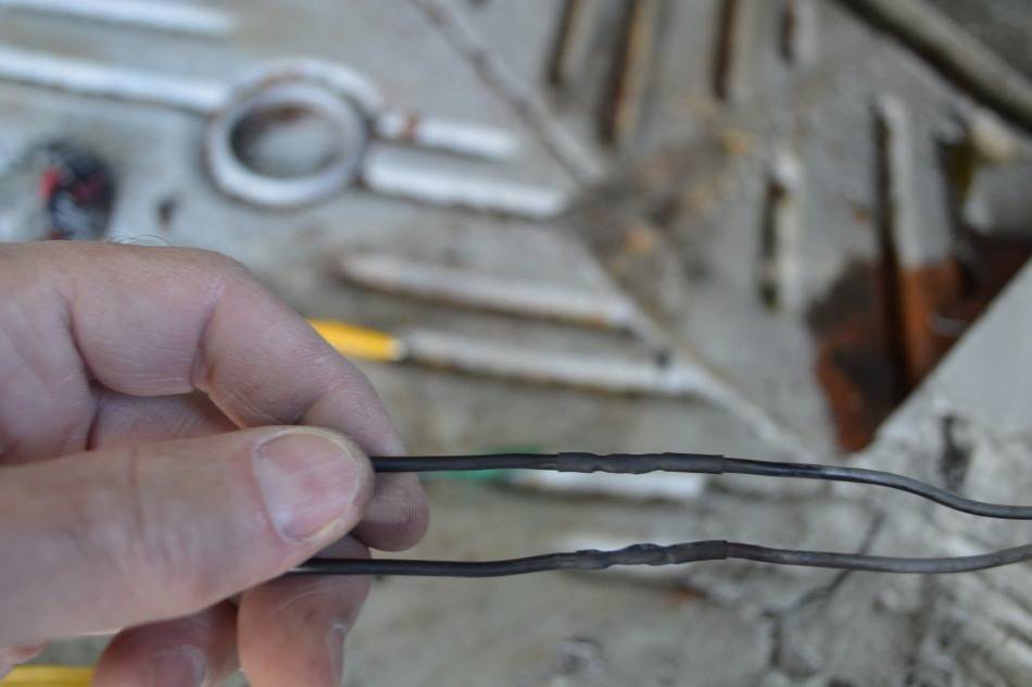

At least I got to practice my outdoor soldering skills and play with some heatshrink. Eventually I'll find a replacement socket from a parts donor (the socket unplugs from the harness, no soldering required) and do it right. For now it's a little safer to drive, if it ever ends up on the road again.

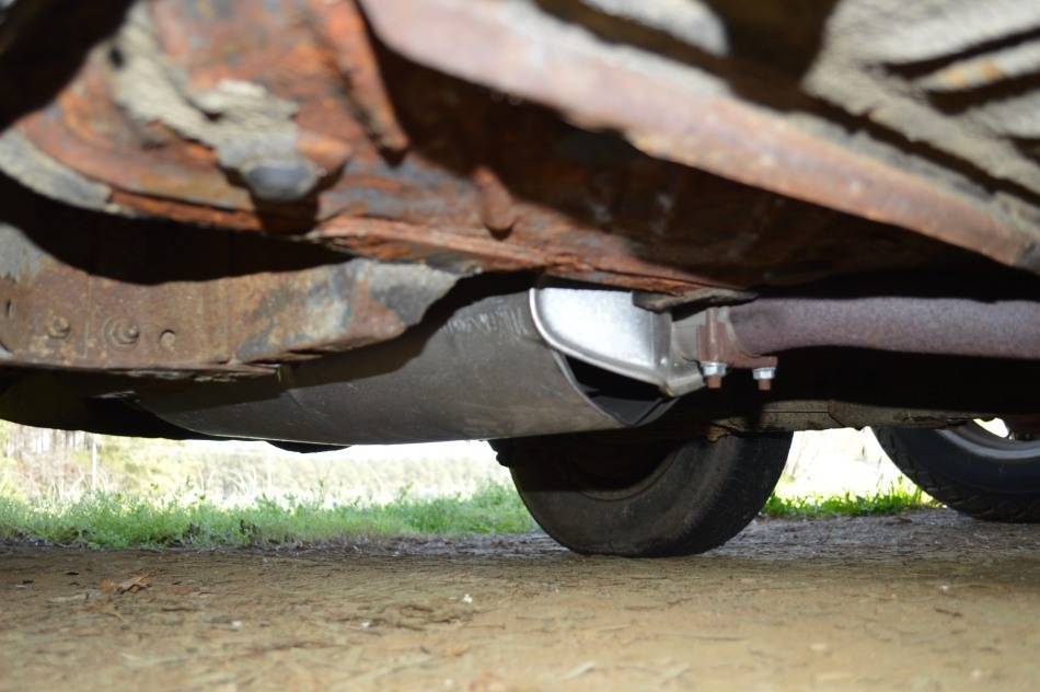

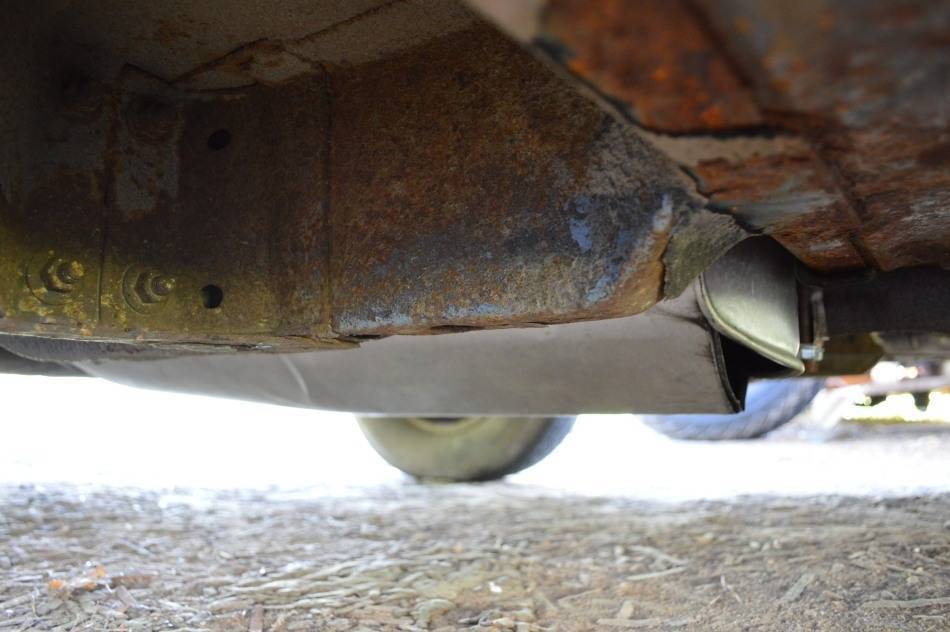

Got home and took a look. Sure enough, a backfire inside what looks like a new muffler. Wonder if this has happened before.
Guess it's getting enough gas?
Boomer, after your last outing sounds like a good name, but let me ask you this, how did the car run after the muffler exploded. If it ran better it could have been plugged their.
