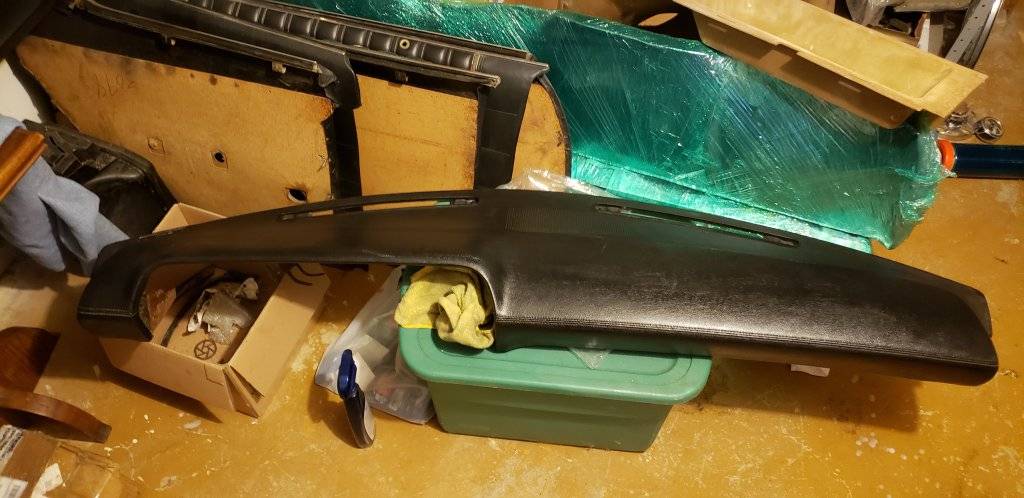

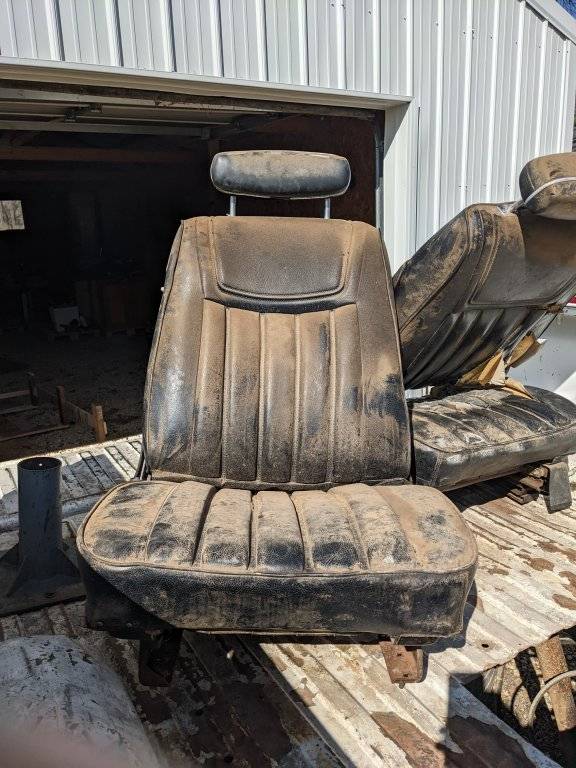

Last summer before the C body show I swapped the original destroyed dash with a NICE original non AC pad. I repainted the dash frame and went thru the cluster changing bulbs before reinstalling the entire dash. I also added bucket seats from a 69 Monaco being parted at French Lake auto parts in MN. I had @LocuMob scoop them up for me. What a great pal he is... I even managed to find seat covers that match what the backseat had when it arrived. Again, making sure to keep the original spirit of this gem intact.

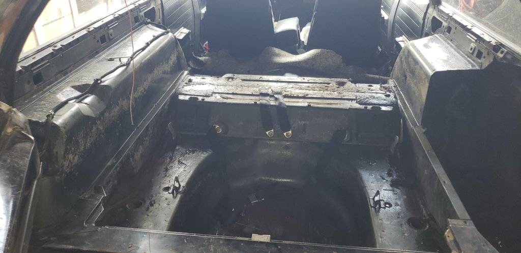

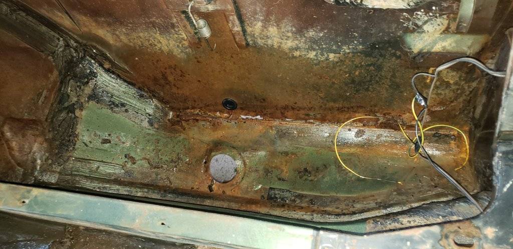

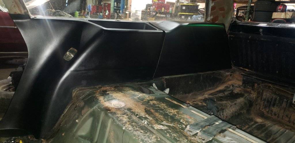

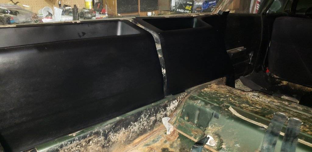

I was sick of how worn and faded the interior was looking, an unknown source of never ending dirt/mud making it impossible to keep clean. It was time to dig in to the rear of the wagon and get to the bottom of things...

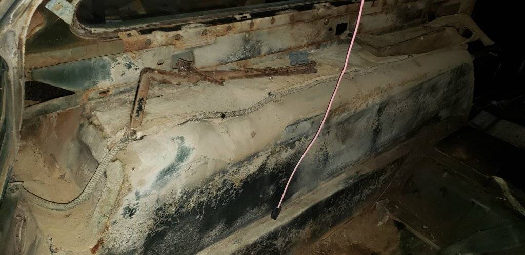

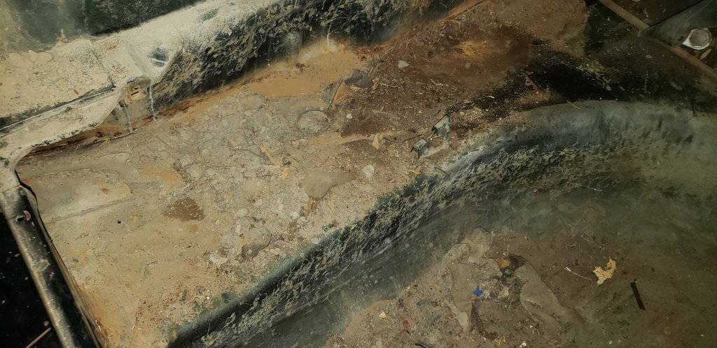

When I pulled the plastics and seats out, I found a BUNCH of dirt behind all the panels. From living with its rear window down at that little airport in Salmon? Who knows. I pulled everything out and got out the pressure washer, and got to cleaning.
Before...
After some time with the pressure washer, I was satisfied with the results...

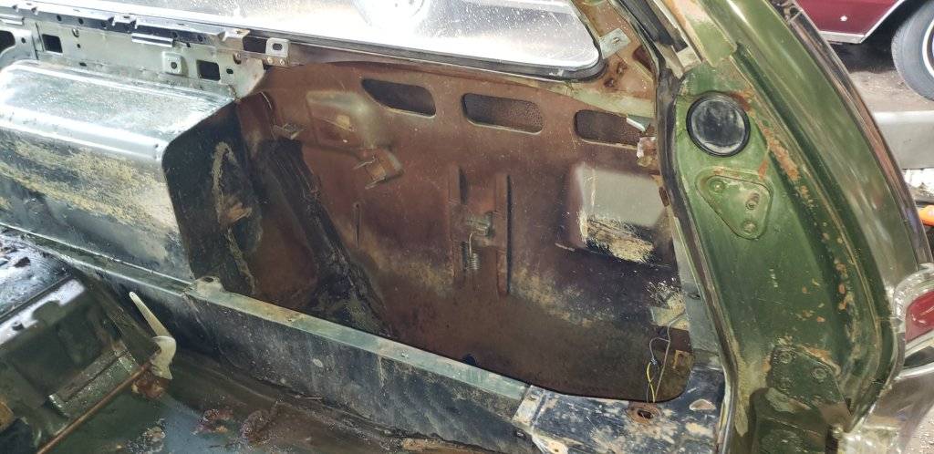

Very minimal cancer in the spare tire well.

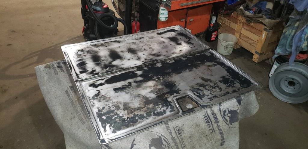

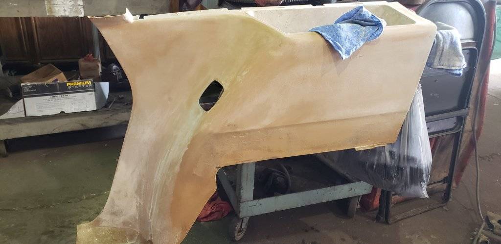

I only had to replace one damaged panel and dyed all 4 with SEM
Now for the fun part. Cleaning and prepping the metal folding parts for paint. I wanted to use something heavy duty to avoid chips and scratches, I picked a duplicolor high build fleet coating in semi gloss. Seems to be slow drying but I am satisfied with the results so far...

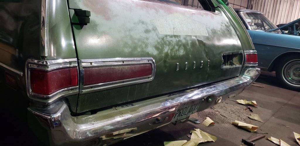

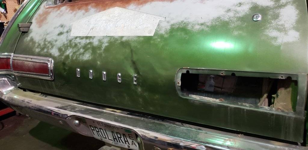

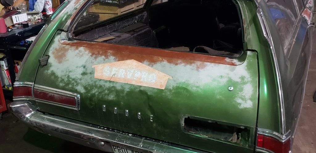

While I was back there...the giant dent in the tailgate was staring at me and I decided to attempt to get it pulled out. I had to be careful as I didnt want to hurt the paint. I pulled the tail light to have a way to get at the inside of the gate. I removed the E from the Dodge lettering. I then used my slide hammer and gave it a few pulls. Heard a big pop and this is the result. Far from perfect, but much much less of an eye sore.

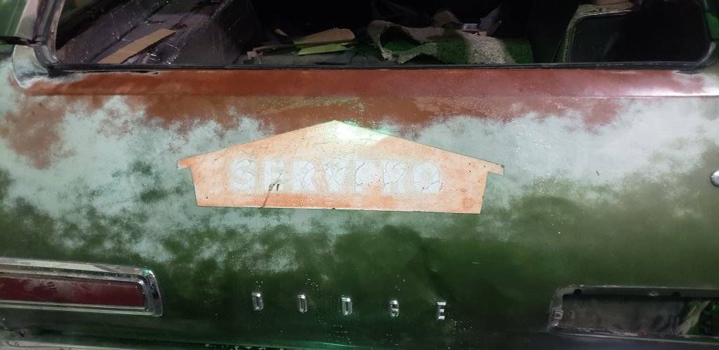

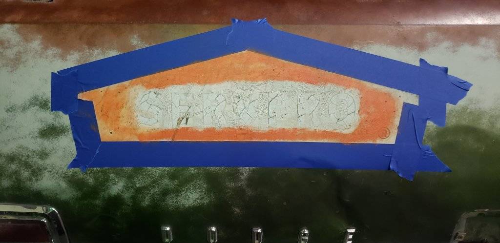

Next up, after sharing my dent "repair" with @ayilar he mentioned the servpro logo was looking more worn than normal. This logo has always looked burnt and faded worse than the doors. I decided to gamble...
I took some orange Testors model paint, ya know in the little jars? I smeared a little in one spot, then quickly wiped it off with a rag that had some carb cleaner on it, instantly regretting touching it with the paint...the result of my "mistake" was too good to be true. I taped it off and carefully smeared and wiped until I was happy. I then took 1500 grit and wet sanded over it to help make it look worn...the results are excellent imo...

Those bucket seats are very hard to find............I ended up buying a 69 Monaco parts car just to get a set of those for the 69 Monaco coupe I want to restore some day.............................great score!!
Wyatt had me on those seats like flies on...
Yes as soon as I found them, I had Scott promptly go grab them up for me. The passenger seat reclines!

I know. But it just would take away from the overall appearance of the car IMO. That dent is part of its history, and some have told me I should have left it alone *cough cough* @LocuMob
The car has a bumper hitch and the dent is right in line with the hitch...if I had to guess the door wasn't shut all the way and someone took off and the gate swung open and slammed into the trailer jack.
