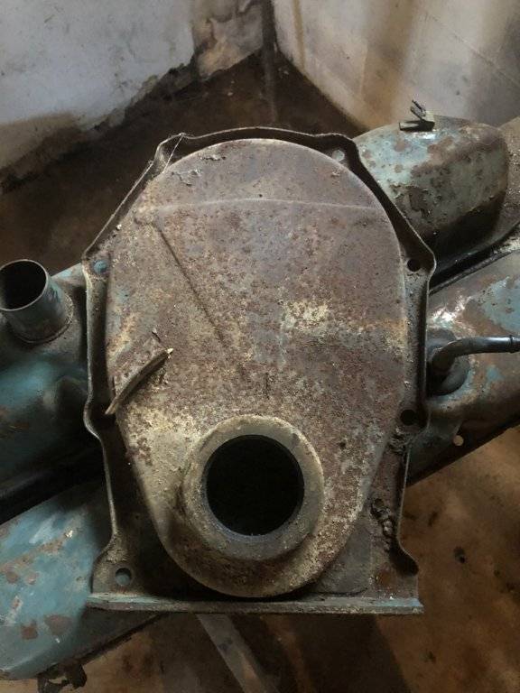

FYI,if you were not aware,early 318's the timing cover issue is not uncommon.
They are known to corrode to the point of leaking.
If you plan on keeping the 'teen in the car,
be sure to score a good decent cover 68-69-70. 273 340 same.
They have the timing marks on the passenger side.
Newer timing covers have timing marks on the driver's side.
A sensous repair.."since you was" there do a timing chain swap same time.
If you can only find a newer timing cover,get the matching balancer with the timing mark to match up.

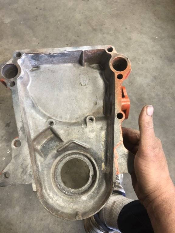

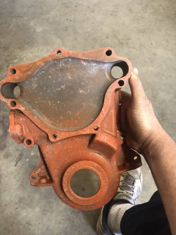

I actually have a 69 timing cover in the shop right now! There is a pellet sized hole by the dipstick...I was filling the radiator with water to see where my leak was. Got towards the end of the gallon and it started peeing straight up next to the dipstick, my father and I were like...HUH? That's the cracked block???? Excellent.

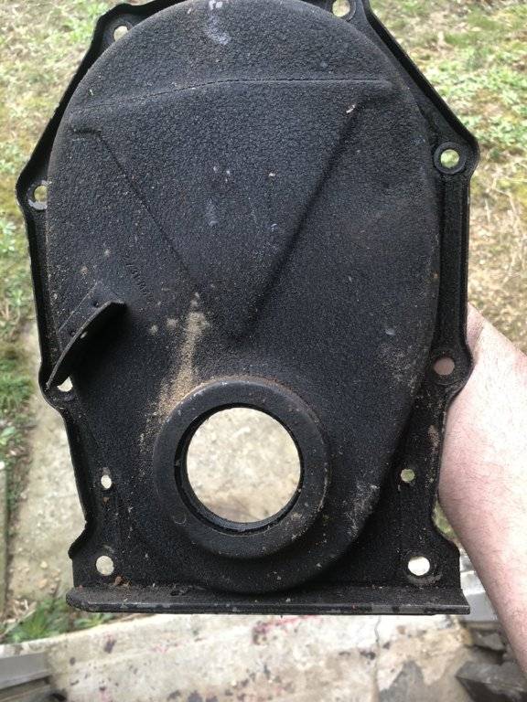

I’ve got a newer style cover if you need it.

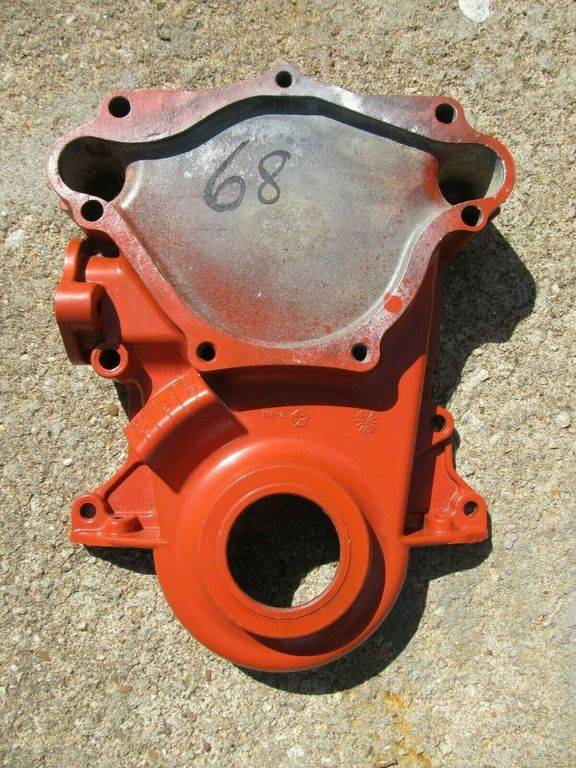

68-69 Shown here for comparison to your pic and reference for others who were not aware of the difference...
