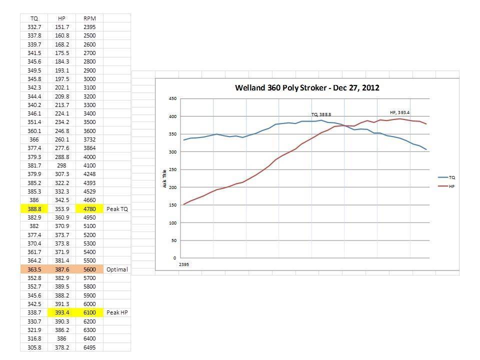

There's been lots written on poly performance. They have a long flat torque curve as shown in the dyno numbers:
May I ask what cam and heads on this small block monster?
Sorry to rekindle an old post but to close the loop on this question here it is verbatim from the engine builder:
"The camshaft in your engine is a Racer Brown ST-22 which has 242 degrees duration @ .050 lift and a lobe lift of .340 inches. That calculates to .510 lift with a 1.5 rocker ratio less the lash. The valve lash is .016 intake and .018 exhaust set cold-------but, I always set both at .014 cold----seems to be better to me."
