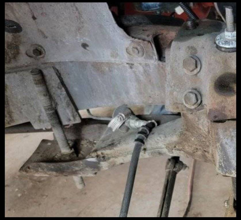

They're clever for sure. But all the rubber cushion pads all over the car make for a really weird waddle.
Thanks for the photo, BigMoparJeff. I remember now, as my Dodge Aspen work was last done in 1992. That illustration you posted shows those huge rubber isolators on the torsion bars that I now remember. Plus, if one looks closely at the original poster's photo, the traditional torsion bar can be seen hiding to the left side.
I now concur; definitely not Aspen Volare, BUT...I remember those sliding slots for alignment. What a nightmare.
Chrysler made some cast iron "isolator replacements" for the NYC Volare police cars. I saw mention of that years ago, with a part number.

That's probably a good idea. It was a long time before I figured out that my 5th AVE suspension or steering wasn't worn out, but instead the isolators were letting the body move around on the chassis sub frame parts. Back and front.

Considering that the sub frame is attached with a piece of all-thread tack welded to the main frame of the car, I'm going to guess that there wasn't a whole lot of engineering that went into the build. I wouldn't be surprised if the caster is way off and that's why the car handles strangely. Once you've got it all back together, you should bring it to a decent alignment shop and see if they can get it close to spec.

That's not a '69 Fury suspension.
Looks like F/M/J body which would put it into late 70's through 80's.
Just a thought, you could ask here: For FMJ Bodies Only
It is not a "K" frame from an F, M, J, body car. Those have "J" shaped torsion bars. and mount directly to the frame. It does have the upper control arm mount like an F, M, J, body car though. Looks like it is from a car with "Iso" mounts. I am going to take a stab at 1973, 74 "B" BODY.
Since the verdict seems to still be up in the air about what this suspension is out of, I've added a picture from underneath.
