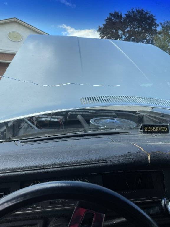

So the car left me stranded this afternoon, smoke rising from the carb. Let it sit called a couple mechanic buds (none of whom could agree on what’s wrong) but the one I think is the most correct said it seems I may have a valve leak. This is causing the engine to overheat, the rough and odd running at times, and the odd lack of power. The car won’t start, and is being towed tomorrow to be fixed. I. WILL. NOT. QUIT. (Even tho everyone wants me to sell)
