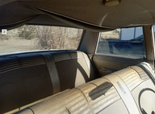

Well . . . the 383 has more muscle than the standard 318 V-8, fwiw. The '67 full-size Dodges were pretty spiffy when new. "Flash" with an appropriate amount of "dash" under the hood for not a lot of money.
From the little bit in the pictures, your possible "to do" list might be a bit long. Get the mechanicals in order first, learning about the car's engineering and such AND why it is better than a similar GM or Ford product (each has their own strong points). THEN worry about the interior and exterior items.

The car looks good, but there's no substitute for onsite inspection.
If that's impossible, I talked to the owners of both my C-bodies for an hour on the phone before spending the purchase cash plus big $ for a car carrier. If you can't inspect and the owner seems the least bit untrustworthy, I'd bail. $1500 is almost in the too good to be true category. Good luck!

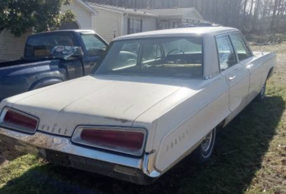

At that price you can’t go wrong, if you can afford to burn that amount of cash without moving your needle either way. This can be an expensive hobby.To restore a c body correctly is almost always an upside down proposition.
Most of the nice cars that you see on this forum belong to people who can drop 20k and not blink an eye.
I’ve seen many lost causes here that not even the most hard core, well heeled fans would touch because they know it’s beyond hope. Why? Rust. That’s it in a nutshell. Engines and transmissions are a dime a dozen. Forget the drivetrain. That’s easy. The car itself,, that’s the important part. Rust is what you have to look for, on the body and underside.
I see possibly the brightwork (upper window moldings) around the windows. That, cloth, and a/c are nice options to have.
If it still runs rough after a tune-up it is not uncommon for the 383 to need a valve job (adding in hard seats for unleaded gas). But do the proper diagnostics first. Other things it might need are fuel tank, fuel tank line, and brake lines.
Master cylinders are a bit challenging in that they will blow out the backsides, leaking fluid into the booster.
Well sorted brakes are good for Grandma driving. Disc conversions are available. The 14" wheels are getting difficult to get tires for in the correct size, 15" upgrade is often in order to facilitate disc brakes and tire options. The factory tire size was a little small in my opinion. With 15" wheels you will have to figure out new wheel covers.
Make sure the windshield is good. Availability is periodically spotty. Call around prior to purchase if it needs one.

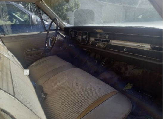

So the in-dash auto-pilot does exist in '67. I have never seen it other than in the service manual. And in the manual it was shown with a factory AC. So I wonder if there was ever a dash bezel for non-ac but with auto-pilot.
But here's a question: Why the different center steering wheel medallion? (different than what I'm used to seeing).
I have a tilt/tele steering column I'm planning to install, do I have to worry that my current non-tilt steering wheel and medalion won't work?
