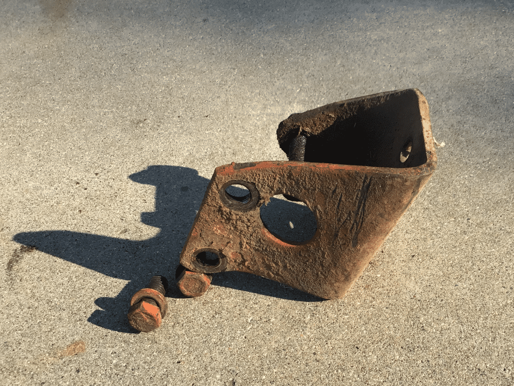

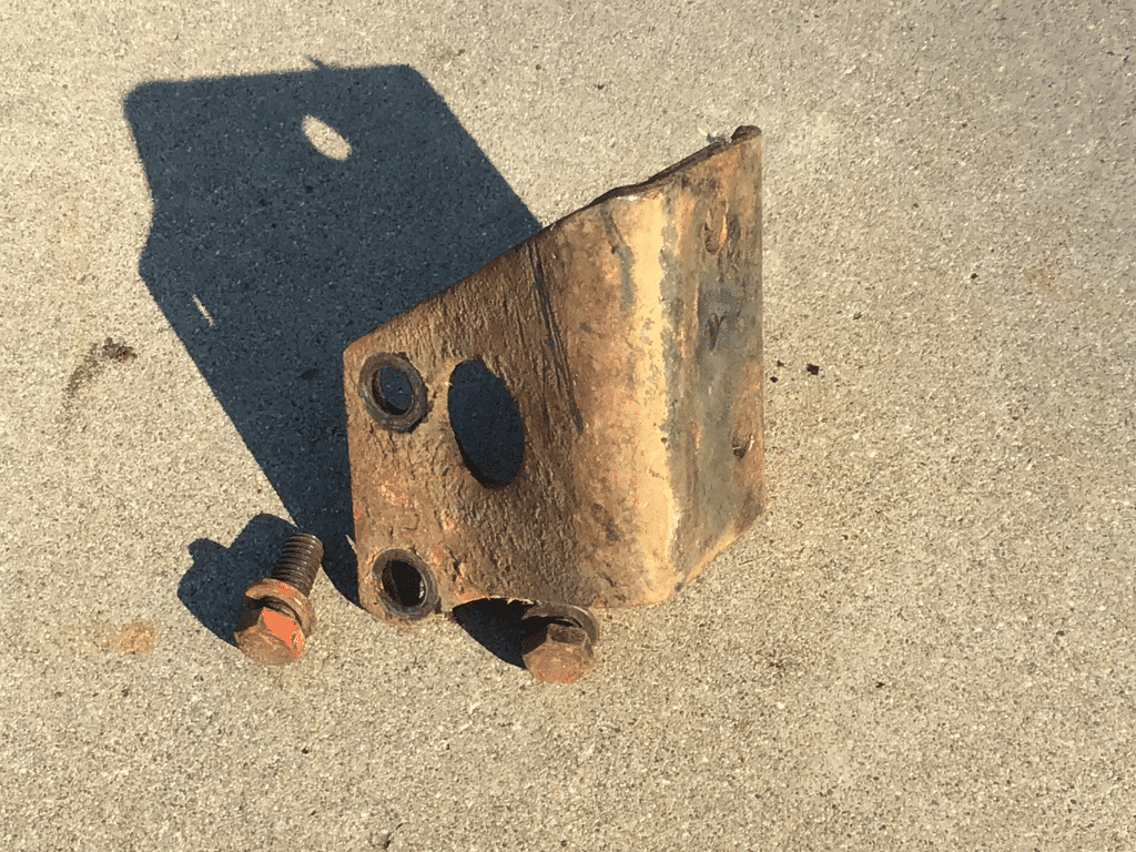

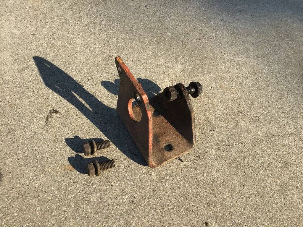

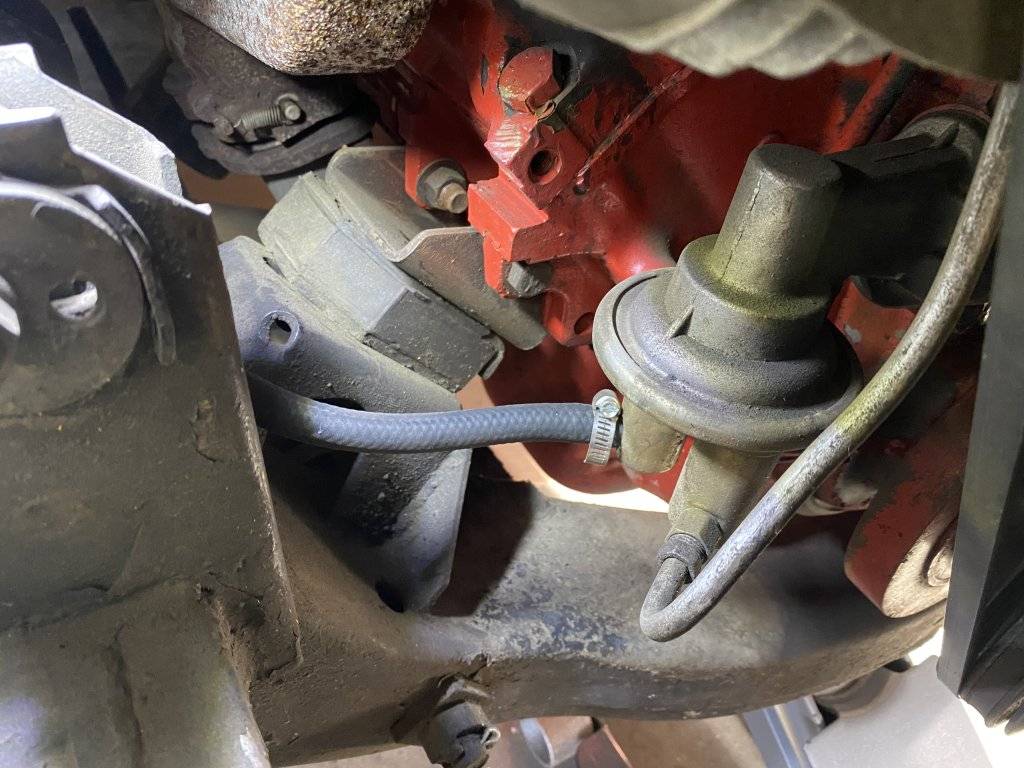

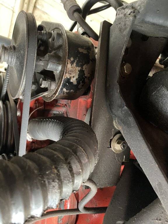

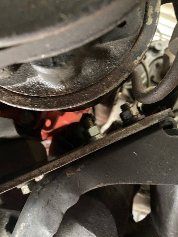

The 65 drivers engine mount is unique, the block needs to have threaded bosses to mount this on the front of the block.
here is a photo of the mount and bolts.
As far as driving, I don’t do much over the speed limit, 0-60 kinda driving highway cruising
There is a LA engine in my car now and the mounts look like they have been fabricated a bit. Would the original poly mounts work on the 413?

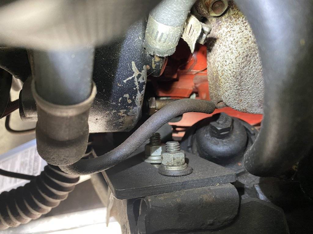

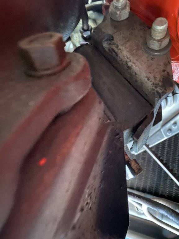

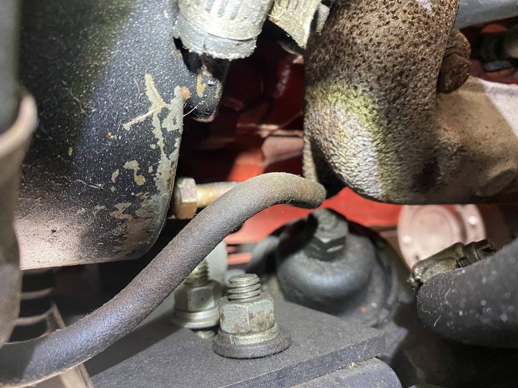

Can you help me identify the mounts
And if they will work for the 413 engine? First is pass side

Your opening 3 cans of worms. Big block where a small block was. 1)Trans is different bellhousing and ball and trunion front driveshaft joint, pushbutton campared to cable column/floor shift. 2) You probably will need 1965 C body, big block mounts. A 1964 Imperial is not a 1965 up C body. 3) all the accessory brackets do not swap, so you end up with accessories that have been dormant since 1985, water pump, fuel pump, power steering pump, (alternator excluded) so you can change them now or breakdown and change them later.
