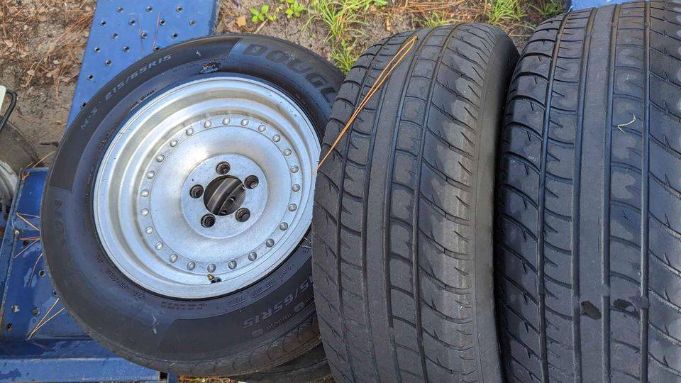

I am looking for an inexpensive, cheap, set of nice wheels for my 65 Sport Fury. I can get a set of 15x7 wheels with tires, the tires will need to be replaced soon. I want to see the stance with the 215/65/15 front and 235/75/15 rear. I am looking for suggestions more than anything. I like this style wheel. They are old, my car is old, and I am old. Nice match. They were on a 2006 Mustang.

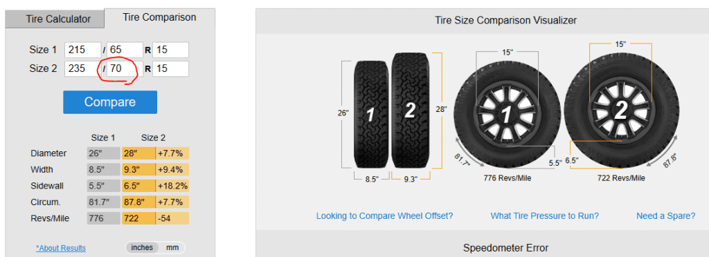

Here is a comparison on my favorite tire calc site. Pretty big difference but one thing most of us have going for us when we have taller tires in the back (mine are only 1" taller) is that the rear fender lip will cover the tire a bit and lessen the visual impact. I say look for a set of used rears a little shorter. The 70 profile along with fender lip would be a good
with 70s

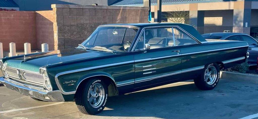

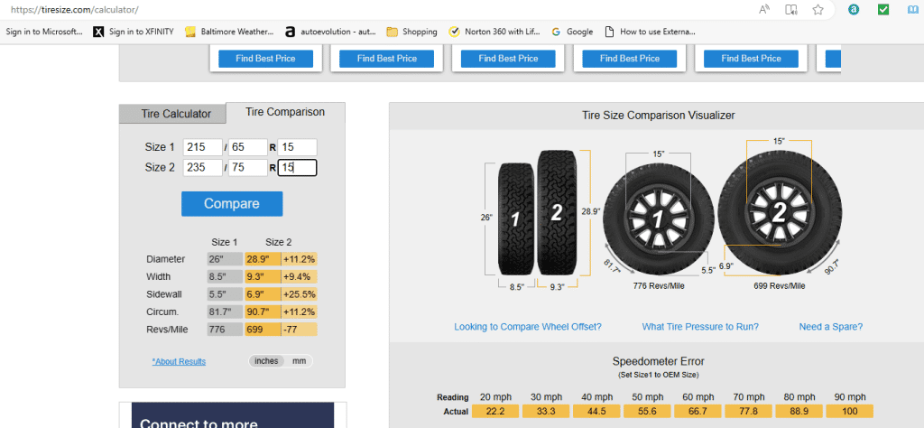

I definitely wouldn't go 235/75-15 rear with that front size, it will look kinda goofy. I have 215/70-15 front on 15x7's and 255/60-15 rear on 15x8's. Would look about the same on 7's all the way around since the 255's can go on either. Sits basically level since they are same diameter tires but looks a bit higher in rear in this pic since the parking space is on a slight incline
I don't think the solid wheels would be an issue. Most cars of the sixties had full wheel covers and most were solid with no provision for cooling. I agree about using the 255-60-15 tires on the back.

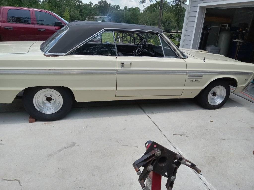

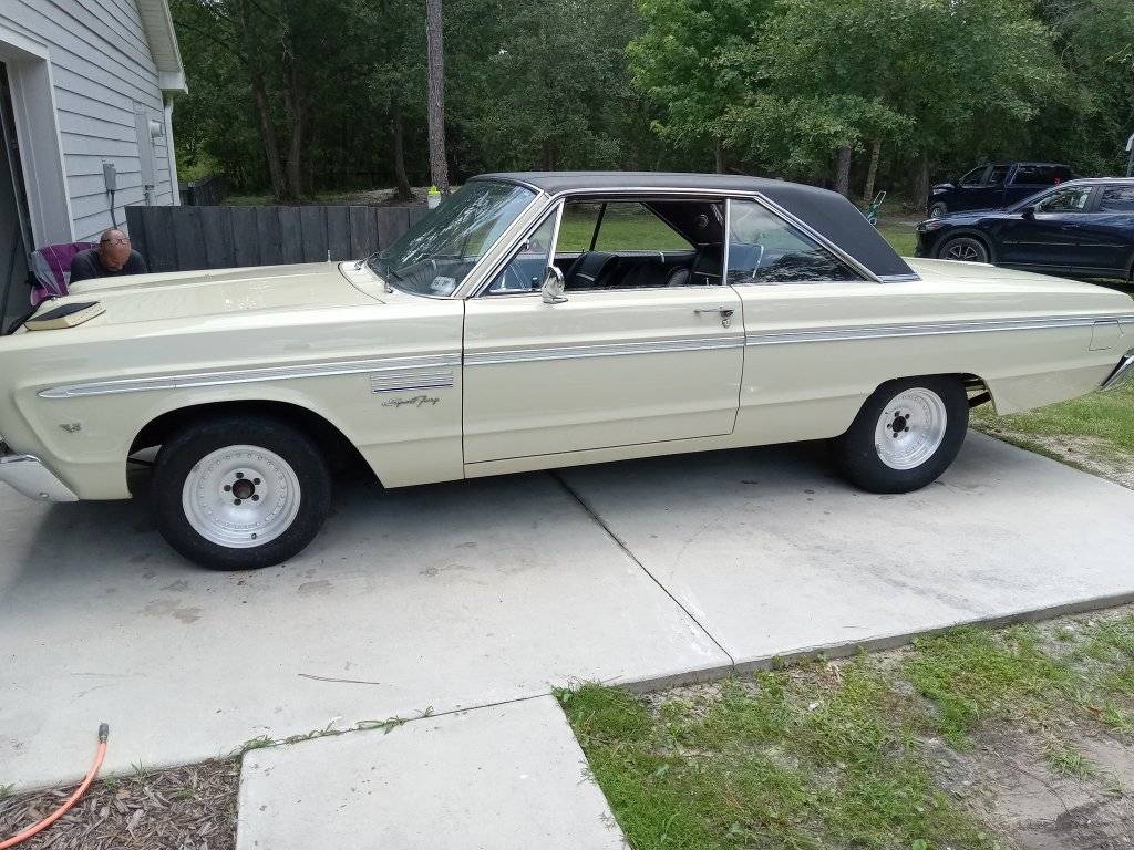

While I was at church today my boys were putting the wheels on my car so we could take a look. The right side went on with no problem. When I got home they said there was a problem. The impact wrench would not take the lug nuts off. When I told them they were left hand threads, they could not understand. I got a big kick out of that.
I like the fit of the rear tires, but the rear have got to be bigger. I meant to say "the fronts need to be bigger".
HAPPY PAPPY's DAY!
I'd go 235's up front, and 255's out back minimum, but I love a 275 if it fits.
