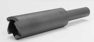

automotive wheel stud swage cutter tool - Google Search
As the BinderPlanet guy used a 3/4" holesaw and noted that it was a slightly sloppy fit, you could look at these:
McMaster-Carr
These are a little thicker and might be a better fit (or they might not fit over the stud, I dunno)
But you'd need an adapter to put in your machine, and these things aren't cheap either.

I was looking for a cutter and found this post on another forum. I might try this.

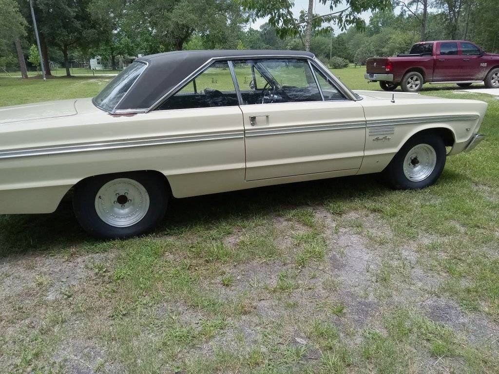

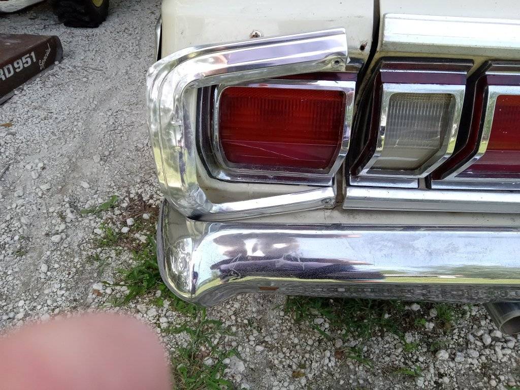

I decided to put 235/75/15s all around. The left rear now has RH Thread studs I pulled the left front hub a few minutes ago. Now to see how I want to change those studs. I also got dual exhaust installed last week. Anybody know where I can get the chrome trim for the left rear light?
Check your passenger-side inner taillight and see if the lettering is at the bottom of the lens, or at the top and upside down.
It looks a little crooked in that pic, somebody might've installed something incorrectly.
The 237/75/15 makes since to me. That's what I put on the 64 New Yorker.

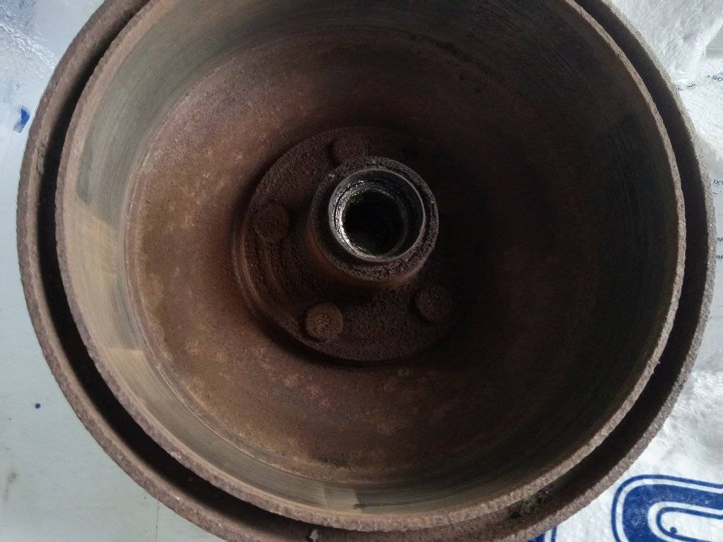

My opinion on removing the studs is to grind the heads off from the hub side and push them out. So as not to have to deep drill the drum to remove the swedge. Even if you use a swedge remover tool on the drum side, you still have to remove a lot of drum material. And any swedge left must pass through the hub that's made of unobtanium. It's not just the visible part of the swedge that must go. There's a lot of expanded lug hidden under the part that you can see.

So far I have done what I could to make an easy job hard. I tried to grid the heads off, but not enough room to get my side grinder to get them done. I cut the studs even with the drum and even drilled through the studs. I finally found a video where a guy used an 11/16" Hole Saw. I decided to spend the money and get one. A major investment of $11.32 did the trick. Very happy I did. The one I got,
Lenox Tools - 1772425 LENOX Tools Bi-Metal Speed Slot Arbored Hole Saw has a drill bit in it.​
Same here. No one in town had it. It removed more of the drum than I liked. I had to trim the inside of the teeth.
Thats what I thought to. But no, to small. I had to trim the 11/16 teeth inside to get it over the threads.
I did get the fancy swedge tool. But it ate up to much of the drum. And was working on cutting into the hub also before it got the lug to slid without excess force.
What you did is as good as it's going to get for working from the drum side.
