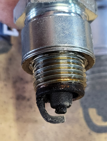

Pulled the worst plug and it's starting to clean up on the tip, but still oily at the threads.
I expected most of those changes since I have it tuned on the lean side and have unblocked the exhaust crossover.
I'm going to proceed under the assumption that the oil rings are carboned up and take steps to clean them up, then re-evaluate.

With a warm engine and transmission in 2nd run it up to redline, if you have oil smoke then you have a ring sealing issue. On the same run while keeping the transmission in 2nd let off the throttle and if you get smoke then valve seals/guides are the likely culprit. If you have smoke when running the engine up in 2nd then I would check compression again with the throttle blades open. 110 psi is pretty low. The "steam cleaning" option can clean gummy/sticking rings. If "steam cleaning" doesn't work try pulling all the plugs and spraying a carb type cleaner in the cylinders and let it sit overnight. Crank engine over without spark plugs to get rid of cleaner and any loose gunk. Either cleaning method may/can put debris in the pan so a good time to change the oil. Look closely at the oil that comes out. A good way to check the oil is with a funnel shaped paint strainer with a coffee filter inside of it to catch the small stuff. You can also consider sending a sample of the oil out for a chemical analysis. Most places that do oil analysis will provide a sample bottle. This should give you some good info as to hydro carbons, and fuel in oil. It will help to pinpoint blow-by as well as too much fuel. Once you have the foundational info and all is then it's back to carb/ignition tuning. If your not running a carb insulator it is a highly recommended option especially with todays ethanol laced fuel. Your comment regarding tuning any new carb is spot on! Congratulations on understanding that as well as your efforts on jet and metering rod changes. It is a tedious process but well worth while once you have it dialed in!

Looks like everyday automatic choke fouling from repeatedly starting the engine and letting it idle just to warm it up.
Also occurs every time you pull it in and out of the trailer to go to and from a car show.
Get it out and run down the street holding a steady 45 mph in second gear for a mile or two.
Pull off to the side of the road and IMMEDIATELY shut off the engine and pull the plugs and see what they look like.
If they're still oil fouled, look at the rings or valve guides.
If they were sooty and, now the carbon has burned off, drive the car more and stop starting it up every so often to let the oil warm up without taking it out of the garage (or trailer) and the sooty deposits will be a thing of the past.

I put Kreen in the engine oil and gas tank. Did a good seafoam treatment through the carb and shut the car down and let it sit a few days to soak. Drove it til the tank needed refill, then changed the oil to Amsoil zrod 10w-30. Around that time I also tuned the carb using a wideband O2 sensor in idle, cruise, part-throttle, and WOT. (The carb had to be leaned out in all areas)
Since then I've put about 500 miles on it of average driving. I pulled the #3 plug today. It doesn't look damp or greasy and though it still is black, there is a light-gray crust on it. There is still wet oil in the threads but I'm pretty certain that's because of the leaky valve cover gaskets as I can see the heads are coated with oil below the valve covers. I checked the oil and though it's still golden colored it looks like it's down about 1/2 quart. That is a slower rate than I was experiencing before but of course it'd be nice if it was even less.
Overall, the engine is running great. No smoke, good power and mileage. Leaning out the carb really made the difference I think. Not sure if the Kreen/Seafoam treatment helped or not, but I'll probably do it again when it's near the next oil change.
