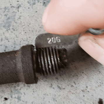

Now when I go to install the front lines, I discover the thread pitch on the end that goes to the brake cylinder does not seem to match the original. Inline is asking me to confirm the thread pitch of the original. I've tried looking it up on the web but can't find any references. Can anyone help me?
Thanks!
Here's what I'm seeing. I sent them this same picture but I guess it didn't help them...
Go to autoparts store and screw into adapters to find out, of just use adaptors

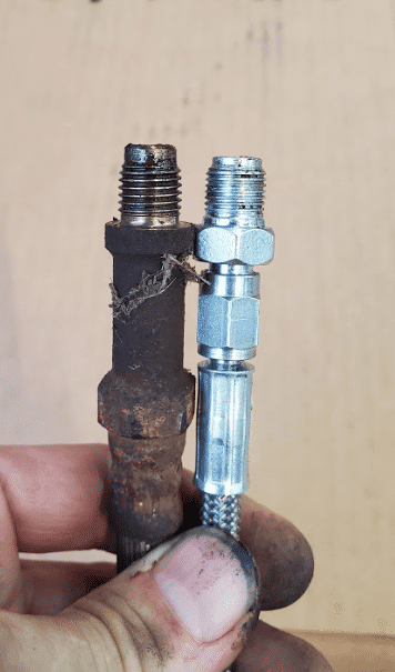

I don't think you can use those lines.
It's been some time since I've done front wheel cylinders, but don't they use a flat seat with a copper washer?
The braided lines you have appear to have a tapered seat.
I don't think anyone makes an adapter to go between the two.
The thread systems they used were completely different between the tapered fittings and any other style of fittings to prevent people from mixing things up.

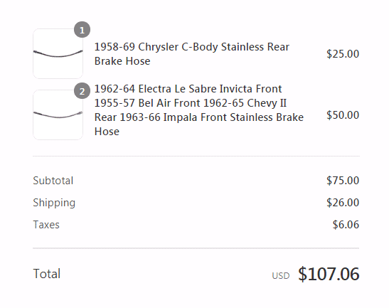

Below is from my order receipt. Yes, I know #2 doesn't show Chrysler but when you put in 68 Chrysler this item comes up. I called them on the phone and the guy on the other end assured me it was the correct part and explained they just didn't have enough room in the description to put every model those fit (i.e. Chryslers). After all this, now I think that sounds like BS, but even still, #1 didn't fit as delivered either, they had to send me a different fitting to put on it.

There's not enough info on their website to come to any conclusions.
Looking at Rock Auto, the other listed applications do use similar hoses to Chrysler.

Typically the fitting are 9/16-18 and 1/2-20. Napa has adapters to 3/16 flare for both. The 9/16-18 is an oddball pitch used mostly by Chrysler.

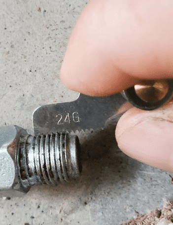

My thread pitch tool came in today so I'll get a chance to check it tomorrow after work and post the results

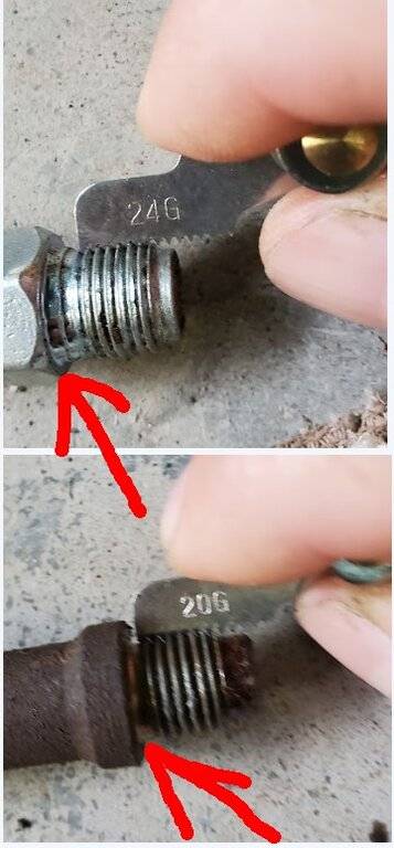

The inline fitting is on the left, the Chrysler fitting on the right.
Just as big of an issue is that the new hoses don't have much or any of a flat shoulder for the washer to seat on.

yeah and they told me they don't have fittings that do have the flat shoulders. I assume the brake cylinder doesn't have any kind of taper that that would snug into? (I can't look right now)
