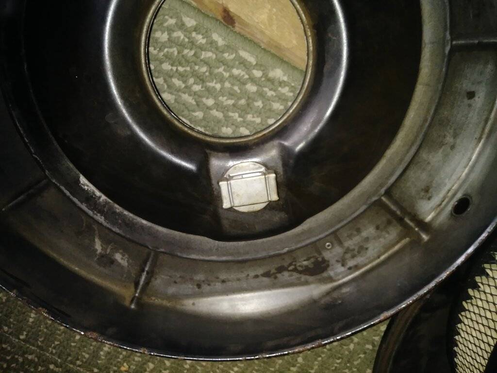

So, I pulled off the air cleaner and checked the three vacuum hoses that come off of it and all was well. I looked things over, found the idle screws and fired the car up. I noticed it seemed to be running better. I let it warm up and moved it around in my driveway without the air cleaner to get it to click down to the super low idle I'd been experiencing and I couldn't get it to do it. I still idled it up a half turn on both the curb idle and fast idle and it sounded great. I decided to throw the air cleaner back on and the second I put the vacuum hose on the back of the carb that goes from the throttle body to the sensor looking thing in the air cleaner (technical name for it, I'm sure) it immediately bogged down. Vacuum line is clear and in good condition.
I've pinpointed the location of the problem but in researching what it is that is in the air cleaner and what I need to do to it, I've come up empty. I'm guessing there are more than a few on here that know exactly what is going on. I wanted to just leave it undone and drive but thought I check with everyone here first. Thank you in advance for any info you can provide!
First off, that is not a throttle position sensor, no such thing in '72. That is the sensor for the preheat tube. Starting in about '70, some mopar vehicles had a vacuum motor attached to the air horn on the air cleaner that operated a small flapper valve that diverted incoming air from the air horn to the heat stove located on the driver side exhaust manifold. These sensors were famous for blowing out if the engine farted back thru the carb. Then they would leak. Part has been obsolete for many years. If this is a summertime cruiser, you can block off the port and not hurt anything. Leaner fuel settings with the start of the emission era could cause carb icing in humid, cold conditions and running warm air off the exhaust manifold helped control this. The warm air also improved performance until the engine warmed up. Trying to find a replacement sensor is going to be a crap shoot since most people just disconnected the sensor if it failed. You might try Murray Park or AMS obsolete to see if they have it.

Awesome!!! Thanks so much for the info. VERY hard to find info on this particular part. No clue where I would get such detailed and accurate info if this site didn't exist. MUCH appreciated!

As the car was running well before the idle suddenly lowered, then what you've found is probably NOT the issue.
That temp sensor gets manifold vacuum, which it then modulates to aim for 100 degrees F inside the air cleaner, thereby allowing a more specific main jet metering environment to reduce vehicle emissions, idle and otherwise. The actuator in the snorkel should get its air from the heat stove on the exhaust manifold, IF the shroud on the exhaust manifold is still present AND connected by the flex tube to the bottom of the snorkel.
If you're concerned about the sensor/motor operating, just put a cap on the vacuum port that supplies vacuum to the sensor.

With no vacuum going to the sensor, the flap in the snorkel remains open, which is what you mention desiring. Also remove the vac line going to the sensor, for cosmetics. Just compress the retention clip to make that happen.

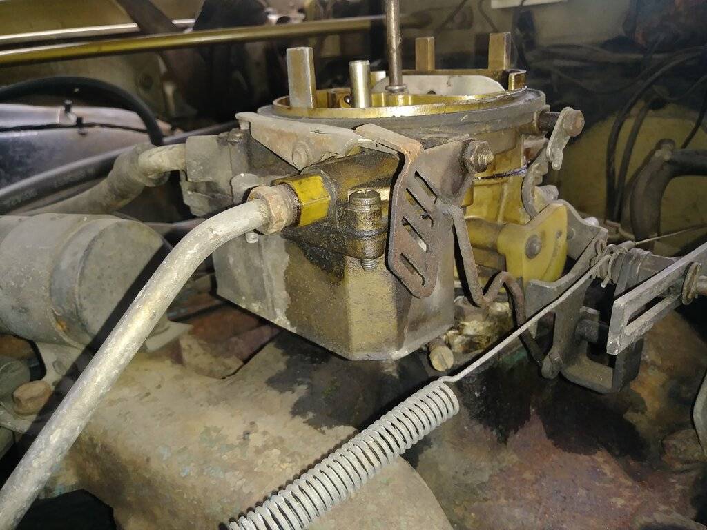

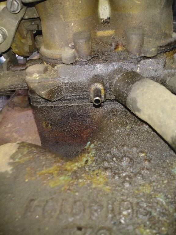

I didn't see anything flowing down the carb after shutting it off but as I turned it on and off a few times to look, fuel started to seep right where the needle is located. Looks like that is the issue.
Judging by how dirty this all is, a rebuild might be the way to go since it has to be disassembled anyway.
From the looks of the fuel pattern on the outside of the carb, it might not be the INTERNAL needle/seat that's not sealing, but the thin metallized gasket between the brass fitting and the carb air horn seeping. Which will, over time, put a fuel migration pattern on the outside of the carb, as pictured. That gasket is basically coated metal that has a bit of compressibility to it, but not very much, but just enough for some additional conformity to the carb casting it seals against.
The 2210/2245 Holley is not a hard carb to rebuild/re-gasket. You might find some small charcoal granules in the bottom of the float bowl. I found those in out '72 2210 when I first took it apart (after several years of use from new). Not sure how they migrated from the carbon cannister into the carb via the bowl vent/evap emissions hose, but they were there. I cleaned them out and it appears they were not causing any problems, other than being where they were.
