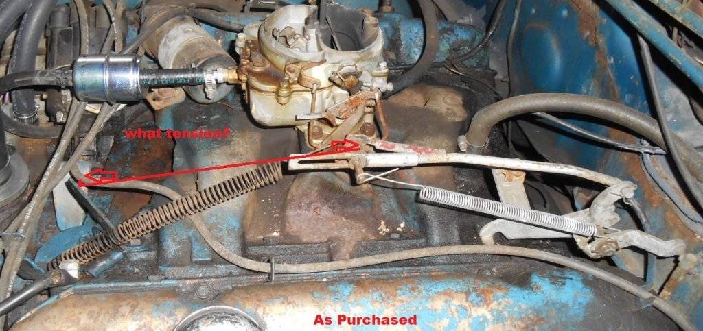

Hey guys, can anyone tell me what the spring tension should be on a properly setup 1968 383 two barrel throttle? Is it smart to go to dual springs? Thanks!

Az far az tension goez....What ever your right foot and calf feel comfortable with. And YES!!!!!! If you've ever had a one spring set up break on you it'll probably happen at full throttle. Do you know what its like to try and stop 4000lbs when the throttle wants to keep the engine at wide open throttle? Cleaning out your shorts iz the easy part, Jer

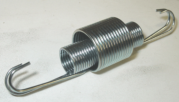

Stan...do you have a part number for the springs in your picture? I can't find where Mopar ever had dual springs... as shown in the above FSM diagram.
You can pick up a Dorman ("Help!" ) assortment package at O'PepadvanceZone for under 10 bucks and mix n match to your liking.
Where the dual springs were used was a mixed bag. Never did figure out what specific applications used and did not use it. I do it simply as a Standard Operating Procedure. It realky, REALLY sucks when a single spring lets go. Ever REVERSE SPIN an engine? Once is all you need to learn your lesson.

Rick Ehrenburg is going to send me a set. They are the ones in the 3rd photo above. I'll let you know how they work out.

All 7 of my Cordoba's had the dual spring setup. None of my 300's had them but do so now. Had to play around with different lengths, rates to get the right pedal feel which after driving drive by wire units all day gets a little difficult.

santa brought me the 2 spring setup like in commandos picture ^^.
they were way strong for my right leg - i want big toe gas pedal, and this was whole leg gas pedal.
i put one end of the springs into a vise and pulled the other end with pliers and gave them a good stretch, and now they are just right.
good call on 2x springs.
