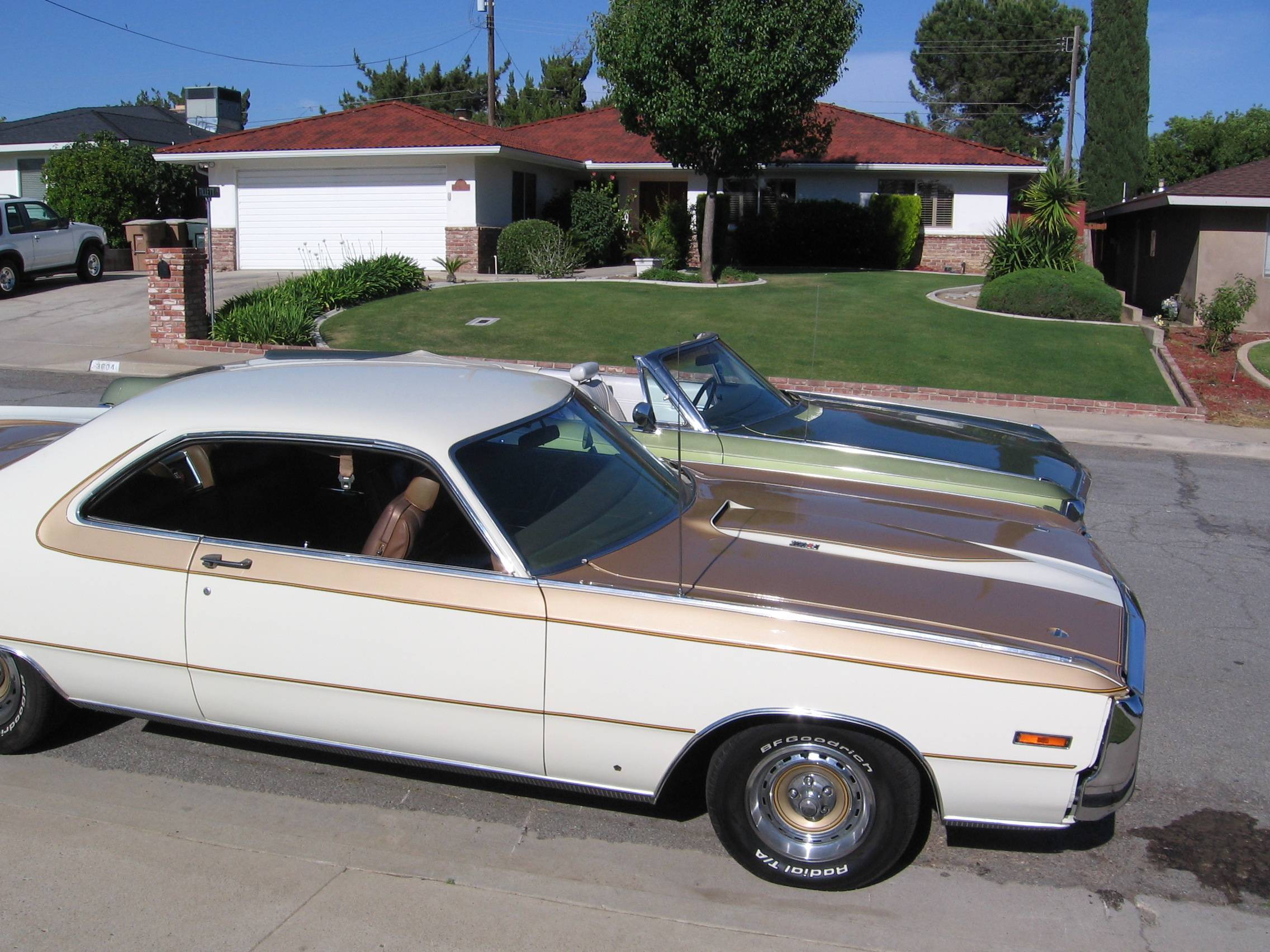

Formal C Cop cars got 2557015 which are 29.1 inches tall.
Recommend a 7 inch wide rim for optimum handling and ride.
I was never a fan of white letter tires, but those sure look good. Must be because of the car. '71 Sport Fury? Really nice.

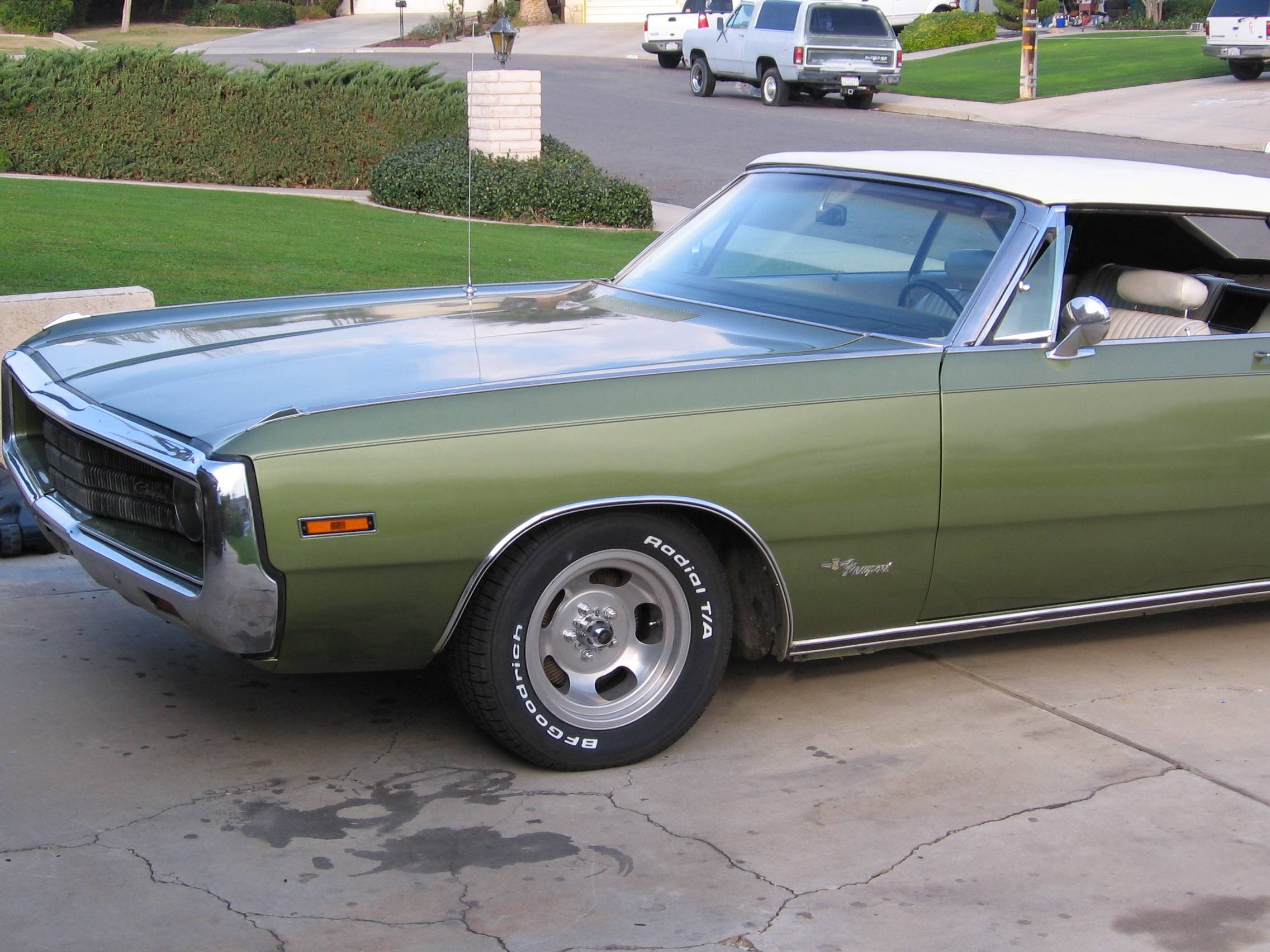

RWL' s on four doors's are a no-no for me.
How many C's came from the factory like that. Very few.
I have that size tire with white stripe on both my cars 70 Polara convertible and 68 Monaco 500. Both ride great and no issues with fit.

If you're worried about the size, don't be. I'm running P235/60R/15 TA Radials on my Newport. A buddy ran 245s on his 300. Both have plenty of room to go larger. My plan is to go larger when my TAs are replaced.
