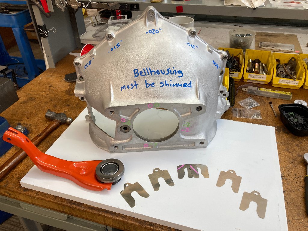

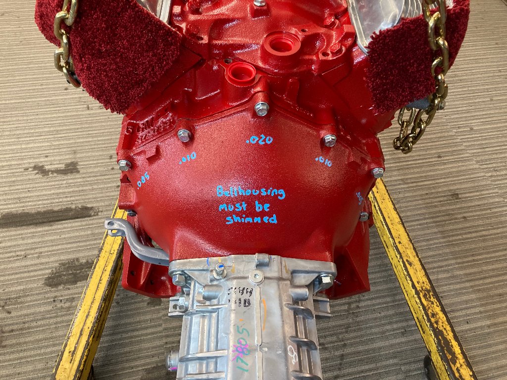

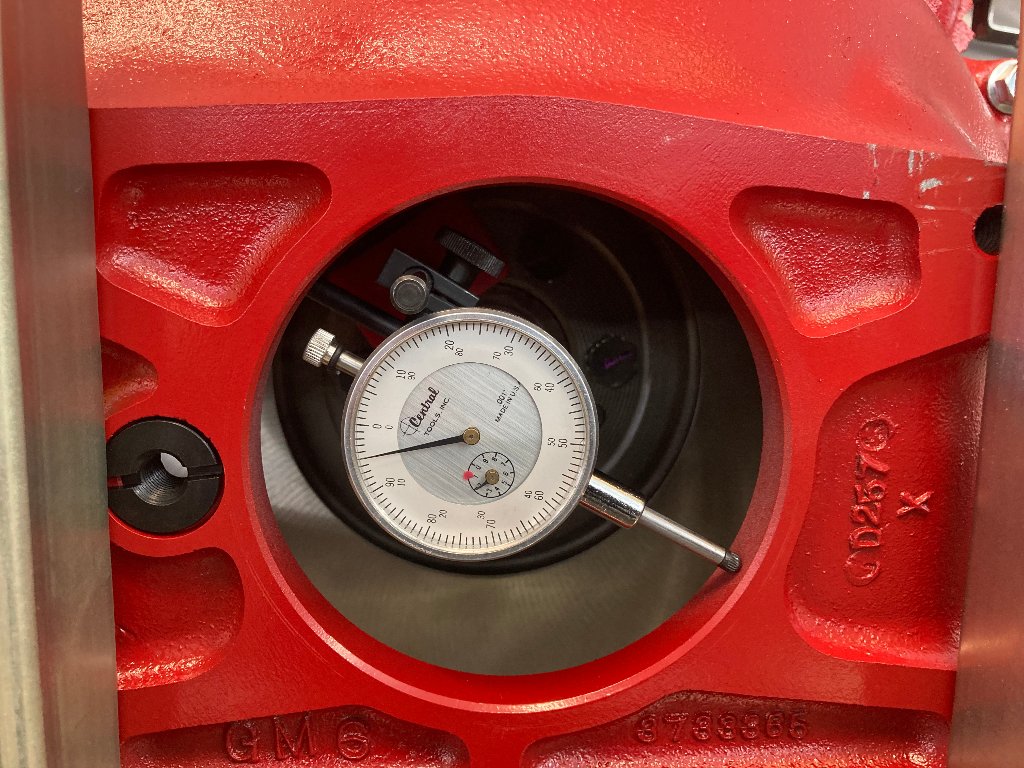

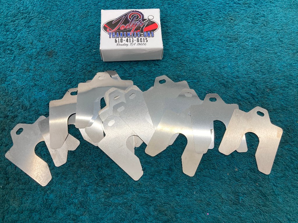

The absolutely most critical part of a Tremec install is to get the bellhousing properly indexed to the crankshaft centerline. The TKX has tapered roller bearings supporting the input shaft, and there is NO freeplay in the shaft like the earlier 4 speeds have. If it's not indexed properly there will be shifting issues and can quickly destroy the trans. There are loads of videos on You Tube about indexing bellhousings, and they're all wrong. They all do concentricity first and parallel second. You want to correct for parallel first then check for concentricity. The machining on the bellhousings is quite good and the problem is usually the back of the block is not perpendicular with the crank. You can buy shims on ebay to correct parallel.
I make it clear on the bellhousing that shims are needed and where they go. The writing isn't visible once everything is back in the car.

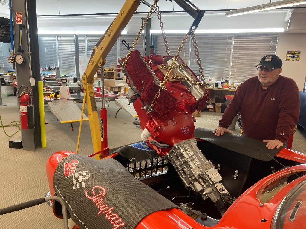

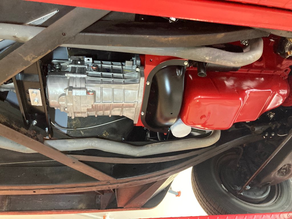

I just finished up a TKX install in a 1963 Impala at work and did another on a 1956 Corvette earlier in 2025. Both of these car have "X" frames, which complicated the installation process.

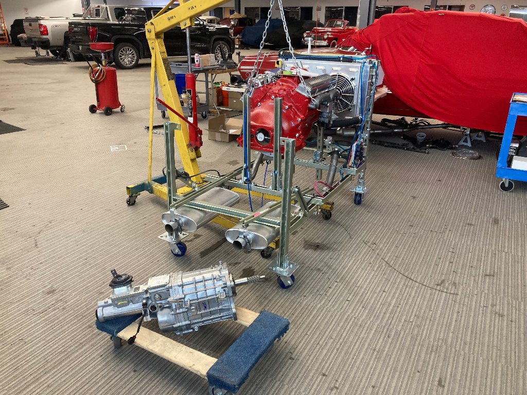

The Corvette has a ladder frame that uses an X in the middle as a stiffener. The X is right behind the transmission and prevents you from moving the trans back enough to get it in and out of the car. Starting in 1958 Chevy moved the X back a few more inches to fix this issue. On our '56, we simply removed the engine and trans as a unit, doing the same when things went back into the car. The engine needed to come out for a bit of a freshening anyway, so removing both was no concern at all. I did the indexing with the engine partially supported by our engine run stand, along with the engine hoist.
You'll need a decent dial indicator with a magnetic base.
I hadn't yet discovered the special bellhousing shims when I set up this trans and instead purchased small round shims from McMaster-Carr. I recommend the special ones, as they have much more surface area.

An engine tilter is a must when removing and installing the engine and trans together.

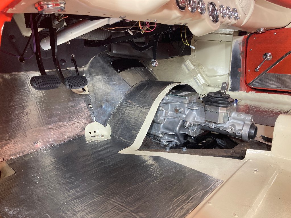

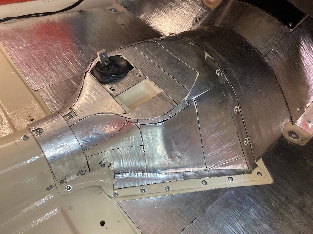

Other than a custom trans crossmember and a shorter driveshaft, the only modification required on the early Corvettes is to slice a 1/2 inch section out of the ash tray pocket in the trans tunnel next to the shifter.
Trans installed in car. Stock spedo cable screws right on.
