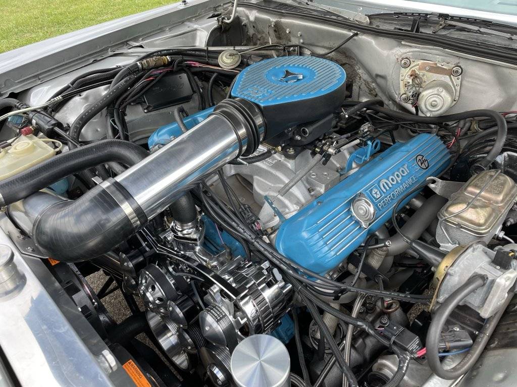

I have a 78 New Yorker with number matching 440 & drivetrain the engine was built by the original owner. Since I didn’t know exactly what I had I pulled the engine out it should be pushing 580 to 600. I have a Holley sniper Trick flow, aluminum heads and cam Hooker super competition, headers Edelbrock intake, bored 30 over. All roller cam rockers etc. I haven’t had it on the DYNO yet horsepower I mentioned is an estimate with everything that was done to it.

Some good stuff here:) Rick T-- Love the 78' New Yorker engine!

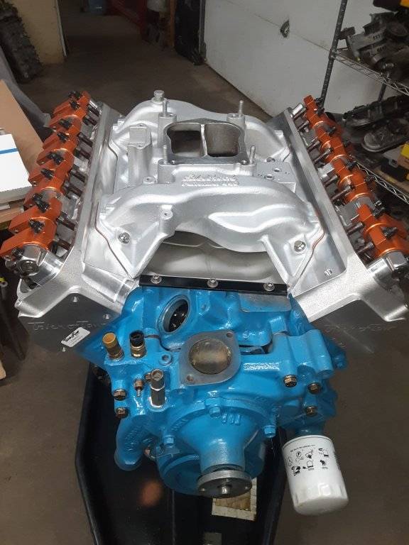

I'm happy to report I'm now the proud owner of a 440 Block. I found a local fellow who was willing to part with one, and in the process got to meet a really nice and very knowledgeable Mopar enthusiast!
Next step is get it to the machine shop for cleaning/magna flux, measuring, etc....
With Christmas fast approaching, I find visions of forged pistons, aluminum heads, and ARP bolts dancing in my head:)
