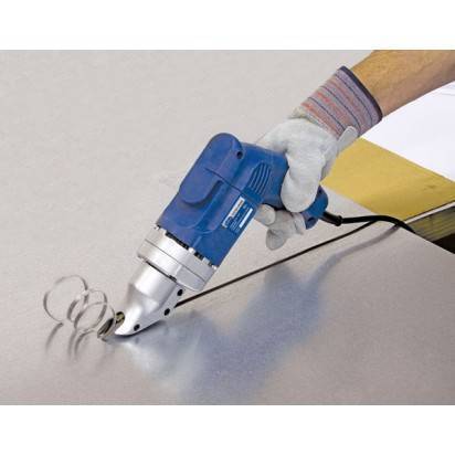

I like this to cut metal. Far easier with no sparks flying.
http://www.eastwood.com/electric-metal-cutting-shears.html

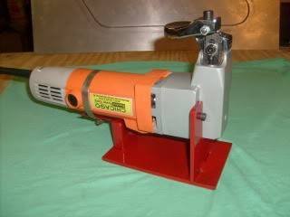

One of the electric throatless shears is what I use. Make a mount so it can be clamped to a workbench or stand and they are terrific. I'll get a picture of mine out tomorrow as the mount is much simpler than this one, but same general idea
Like this;
