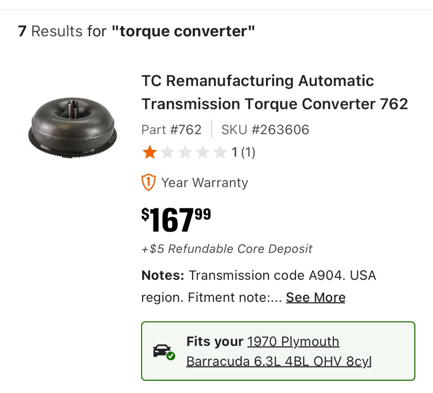

My 68 Polara wagon sports a 1970 383 HP out of a Cuda. The engine is fine but the 727 wasn’t touched. I am trying to research a replacement tc and flex plate to replace the original. Looking for suggestions more on the budget side but with another stall. I see advance and autozone list a 2200-2400 stall when looking in up under the cuda. It’s an 11” converter with 10” bolt circle. Has anyone used the TC part number 762 with success?
I am not familiar with TC Remanufacturing, nor their number 762 converter. However, the pictured product listing shows the transmission application as A904. The A904 transmission was never used behind a 383, nor any big block. The A904 was available behind six cylinders and small block V-8s, except 340. It can be adapted to others, sometimes for racing, but was not factory installed. Its torque converter does not fit in the A727 transmissions used with big blocks, including 383, and the 340.
Looking at the manufacturer website, it shows numerous application errors. They list the 762 converter and A904 behind everything from a 170 to a 440, "with a A904".
The listed 762 specifications show a 27 tooth spline count which indicates the A904 transmission. Someone, somewhere within the company might know how to rebuild a converter, but their specifications/application information and presentation is poor.

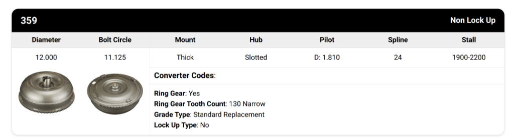

I would likely avoid this company, but after digging into their relatively poor website, they do list a more correct converter for the application, part number 359. Likely it is not a true equivalent to 2801764, but is a generic 10-3/4" replacement. Details about external or internal balanced engine, etc. is missing. The picture actually shows an 11-3/4" (aka 12") converter albeit with a drain plug and no balance weight implying an internal balance engine and non-lock-up. Proceed with caution....
