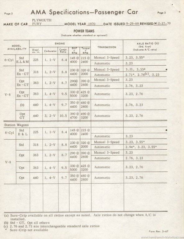

Torque rating for a 383 2bbl?
290/390
There is a significant cam and compression change, which would require a rebuild. If that was your plan, sure upgrade away. A 4bbl intake and dual exhaust would wake it up and a new timing chain would put some throttle response back in it, if high mileage or just original.
Well I'll be putting enough money into body work and I don't need it to be a screamer, so I'll probably just beef up the stock motor a bit.
