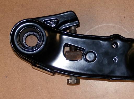

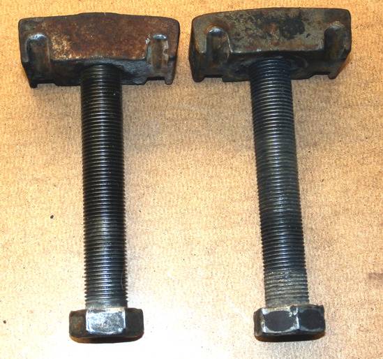

Mixing up the left - right torsion bars would not change the rotation direction of the adjusting bolt. The bolts are screwed "up" (clock-wise as seen from under the bolts) to load the bars. If the adjusting bar-nut is mounted upside down in the lower control arm slot, that might be the reason for the reverse direction being seen here.
