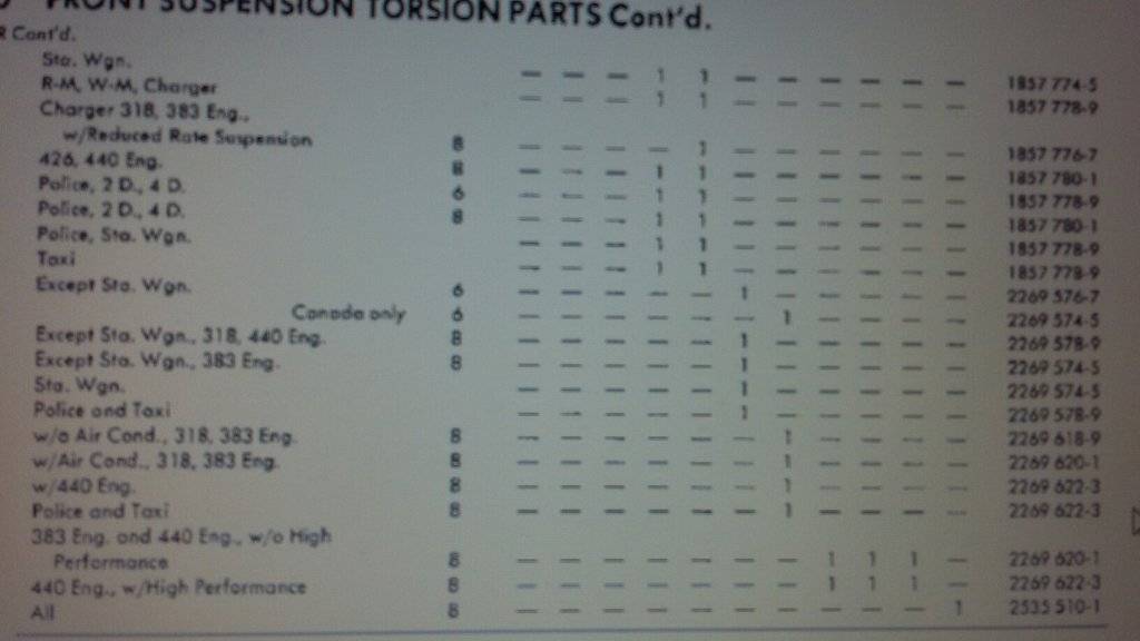

Getting ready to start the swap to the 69 donor wagon body shell. The donor is a 318 car without the factory trailer tow package. My car is a 383 w/ac, and Towing package. Does the torsion bars need to be swapped, the FSM leads me to believe not it lists part# 2269 574-5 for wagons. I am planning to swapping rear ends and leaf springs. I did a search, didn't find a title that fit.
When I looked in my Factory parts book FSM leads me to believe it lists part# 2269 574-5 for station wagons. The other descriptions are for exceptions. If we look at the stub frame threads all interchange except "All 1969 C Bodies, with the exception of Fury hardtops and coupes are interchangeable" Yes I agree they should be measured. So based on a measured diameter and the parts catalogue they may not have to be swapped if equal. If my car has larger ones it may be due to the trailer pack option.
Based on what I see for the second cross member, K-member they are also the same. see attached excerpts from 69 parts book
