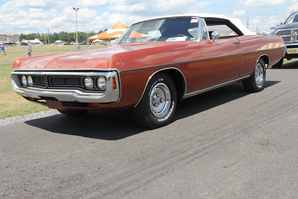

This is the Lucky recipient of the new front end stuff. Since she has the most miles on her by over 45000 compared to the other two and is driven a lot more, she is first on the list.
