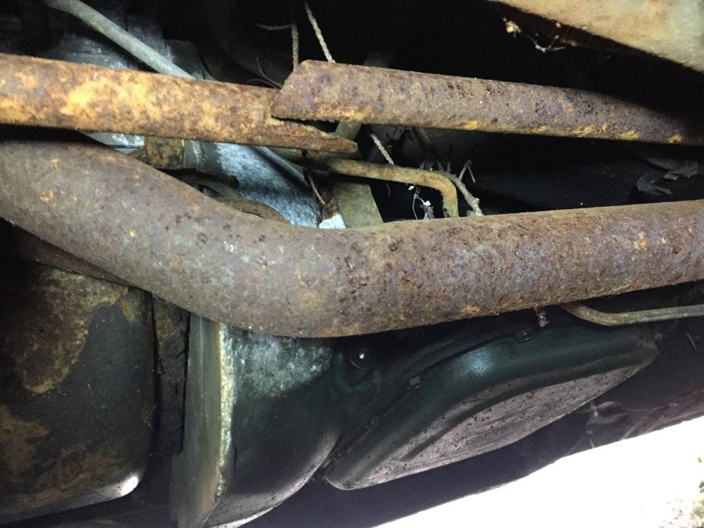

Thought I'd share these pics I just took of a Dart parts car that was sitting on the driver side snubber.I pulled the back of the bar out and saw the break pattern which was interesting.
View attachment 156476 View attachment 156478
This is a factory cast flaw... you can see the rusty area and the cleaner area with a distinct line.
Tells you how little it takes to keep a car suspended.
