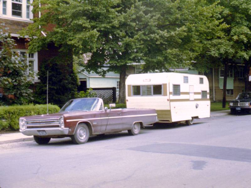

Frame hitch with equalizer bars but no trailer brakes. My 68 318 convertible hauled the trailer just fine. Later I did the same thing with my 70 440 convertible and it pulled it a whole bunch better. Electric trailer brakes would have been a good idea. LOL

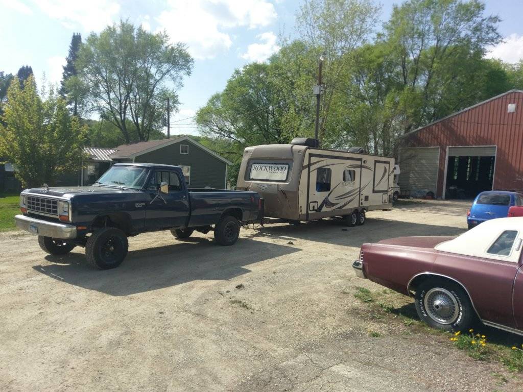

My camper is pushing it lol. It's 27 feet and max at 7000k but it would look awesome with a c body pulling it. And who ever had this car before added leafs and air shocks in the back. It had trailer brakes and a hitch.
I pulled it once with this 84 I restored but it didn't like it, but the tires I had weren't good for it
I had that on that truck and rear bags, it didn't sag at all but the cheap taller tires I think where the problem , it was sketchy. No matter what in the future I want to get a camper to pull behind this thing.

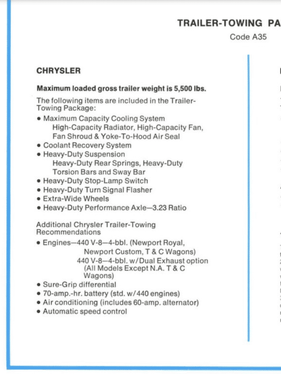

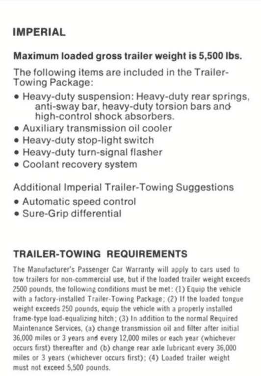

That's about what my trailer weights empty..... That's sad. Thanks for that info I have been trying to find something like that to see what the recommend weight is

I think 7000 lbs is too much for the car. The equalizer hitch anchors to the frame, which is basically sheet metal that's slightly thicker than the body. Then you need to think of the condition of the car. Spot welds don't get better with age and even a little bit of unseen rust inside the rear frame rails has the potential of ruining your day.
Agree with the electric brakes even on that size trailer.

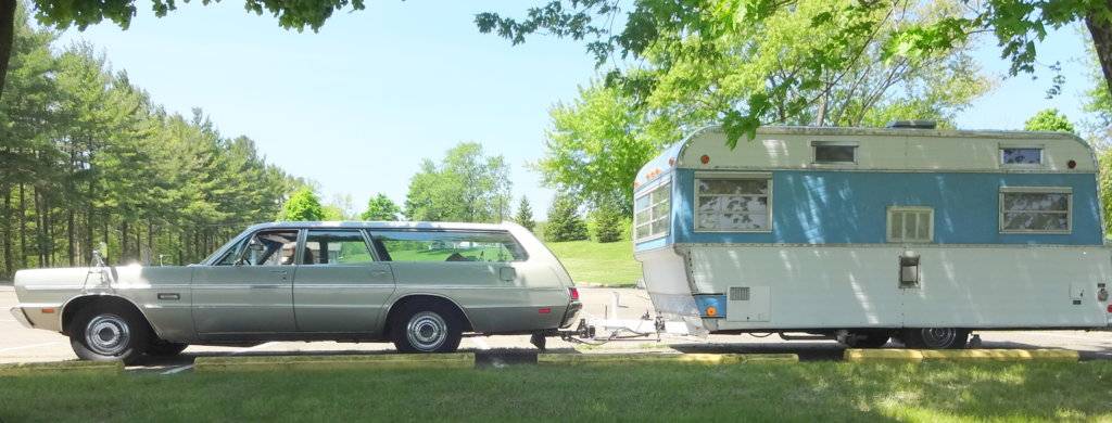

In my garage called “When they were new” you’ll see our trailer pulled by various mopars over a ten year span. It looks about the same size. No idea what the thing weighed but it sure picked up a lot of souvenirs over the trip too. Dad had a frame hitch installed every year on a different car with equalizer bars and trailer brakes.
He never ordered the trailer tow package. Engineers at work told him just order a big block, auto trans, ac and upsize the tires. The ac gave him the larger rad and alternator. Cars ran through the rockies and across the desert beautifully.

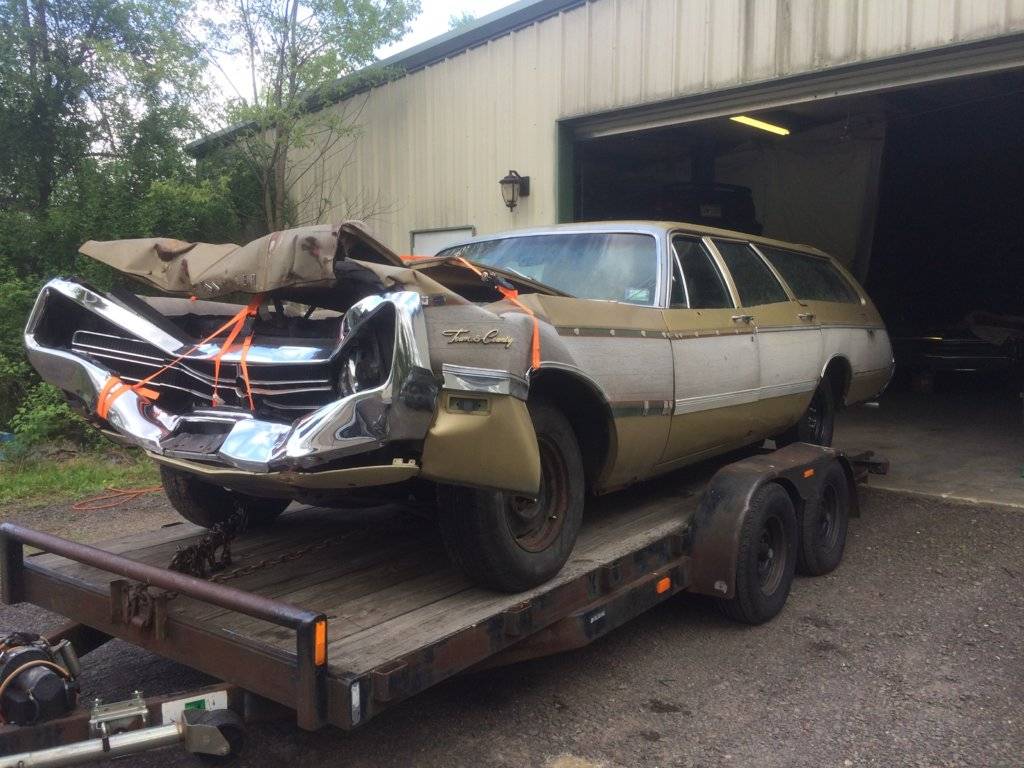

Here's what can happen when you do it wrong. This car was towing a 4-5K pound Airstream in the rain and rear-ended a dump truck.

If you don't have the towing package, you're putting the tranny, motor, and cooling system at risk of a shorter life, and maybe get a custom grill like above in the process! Good Luck
According to @rapidtrans, his dad (who worked for Chrysler) was told otherwise.
Being that Thia car has AC and someone all ready beefed up the rear spring set . The only thing I don't think mine has that a towing package would is the HD flasher
Dad’s concern was he’s not driving a nice car that rides like a truck the other 50 weeks of the year.
What were talking about is a car that might tow the family trailer on a two week vacation each year.
