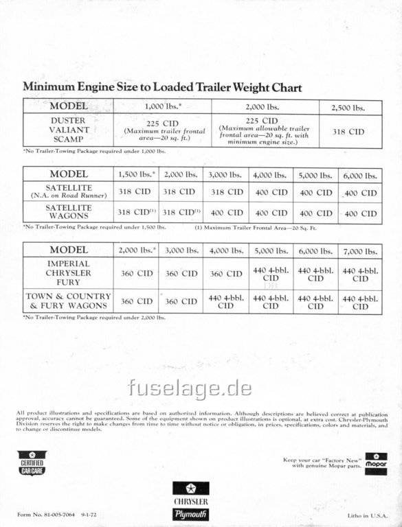

Also this chart shows C Bodies towing up to 7,000lbs
