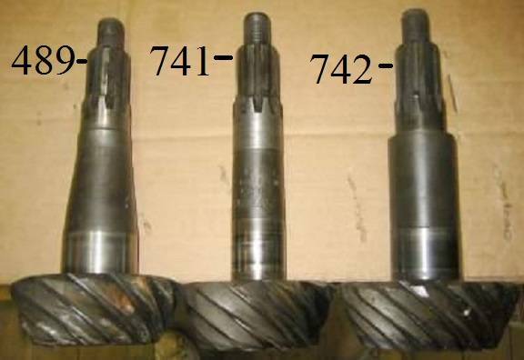

Look at the picture. The three pinion designs all use the same size where the yoke splines on. What that means is they all have similar strength. What differs is the bearings, and how the pinion bearings are preloaded. the 489s have the largest bearings, but use a crush sleeve to preload the pinion bearings. I convert all the 489s I do over to the shim/spacer setup to avoid the crush collar allowing the preload to change.
If you look at the pinion shaft you will notice they are all the same size at the yolk.
