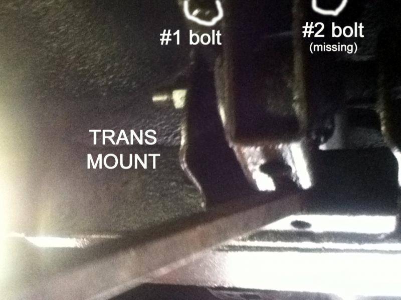

Trans mount bushing is just about non existent and being replaced. Noticed missing bolt...probably dropped in some damn pothole somewhere. I think the bolts themselves are 7/16" approx. 1.25" long (coarse thread?) by eyeballing remaining bolt. Local hardware store has tons of carriage type bolts but automotive types but not many for automotive use. Other sources for these? Think I saw vendor on ebay selling these.

Iz there ah Lowe's in your neighborhood Gary? Grade 5 or grade 8 but don't mess with stainless! You ever hear the word Galling as it refers to tighting S.S. nutz 'n boltz? It'z ah one way trip believe me, I learned the hard way! Jer

HaHa Yea I know Jer......but damn who ever heard of a bolt dropping completely out. I couldn't believe it. Lowe's is a good ride away from me but guess I'll have to make the hike.
I have some good used bolts from some cars I parted out over the years. Let me know and I will mail them out, John.

Go to AAP, they have grade 8 nut and bolt racks in the parts department that they sell individually. Just ask them to let you look through the bins.
I guess I take my local auto parts for granted (napa and autovalue) both have loose nuts and bolts, weatherhead fittings, Hyd hose, etc. but my area is a farming community. and there is always the hardware store or lumberyard. good luck finding bolts
We are talking about bolts? this is not a high load area, even the cheap Chinese crap will be good enough. The aluminum case will break before you have to worry about the bolts. I just go down to Home Depot or NAPA.
