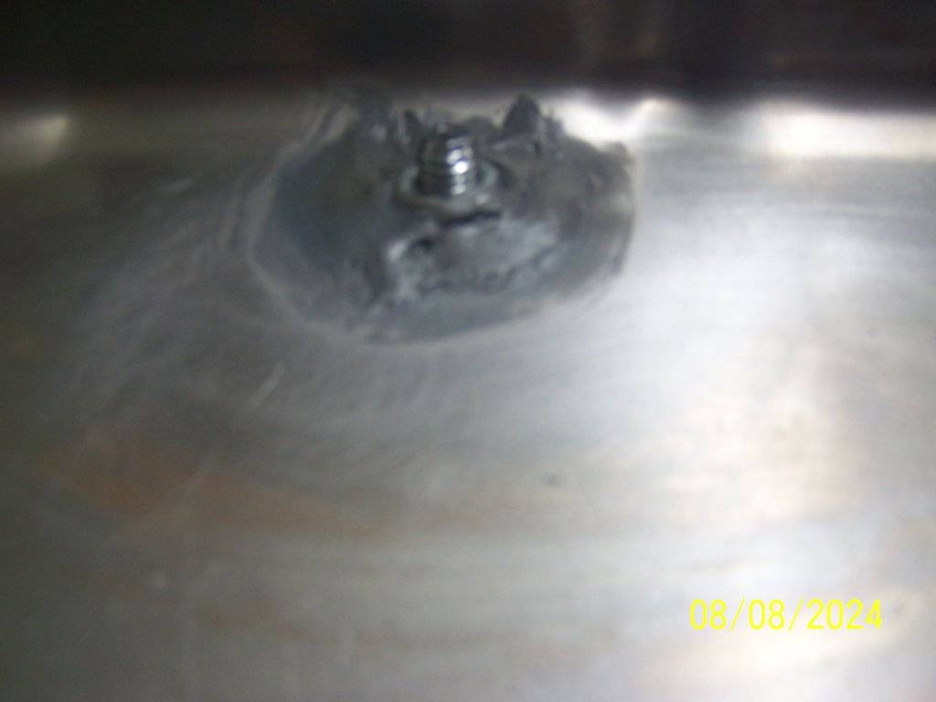

I changed the trans fluid, in my 68 Fury with a 727, last year but it's leaking a bit. Not much at all but it's not fun putting cardboard or bucket or something under the car every time.
I'd like to take out the drain plug and seal it better BUT I'd rather drain all the fluid.
Anyone have a good way to seal it while it's in OR minimize drainage?
Maybe I'll unscrew it a few turns, push up on the drain plug at same time, quickly wrap some tape around threads and just tighten the plug.
UPDATE...I'm not smart. I just remembered I installed a drain plug to the trans pan. ....GREAT!!! I caused my own problem.

He already said it was his drain plug that was leaking. Not the pan gasket. IMO, the leak is around the threads of the drain plug that he fabricated in his pan. I have to disagree with most of your post since none of these older 727 pans had a drain from the factory. The deep pans.....Yes. Also, I don't buy the idea that sealer around the threads like I put on my drain plug are gonna end up in the transmission. They are not going to move until I pull the drain plug. Then, any sealer loosened up by removing the drain plug will come out with the oil. I do however agree with your comment about an O ring.
It's ok to disagree. But the next time your trans is fouled up don't be surprised.
I changed my post to "engine oil pan". And the trans pan drain plugs are the same. Except,your home made one.
My home made one is gonna be just fine thank you. The reason it is home made is because Ma Mopar didn't put one in there. As far as fouling up my trans........Ain't gonna happen because I installed a home made drain plug. That job has been assigned to the filter. When it does foul up it will definitely for some other reason. Such as when I installed a deep pan and didn't pay attention to the extension not being correct for my transmission.
