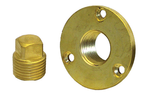

I'd like to add a drain plug to my gas tank. My plan would be to buy this:
It's brass. I would solder the flange to the bottom of the tank, then drill maybe a 1/4 inch hole in the center through the tank bottom, then use an appropriate rubber what-ever material, cut as a disk with the same diameter as the threaded flange and use it as a gasket seal, with the plug screwed in to force the gasket against the bottom of the tank. Using teflon tape on the threads of the plug for insurance.
Looking for a simple drain solution, easy to do, low risk of failure, minimal alteration of the tank, but still absolutely gas-tight.
The above item is generally known as a Garboard Transom Drain Plug (ie - for boats). It's about 2 inches in diameter, I imagine the plug is 3/4 inch. I would use a smaller version if I could find one.
The downside to this would be that prepping the tank and soldering it would disrupt / vaporize the galvanized surface and make it rust-prone.
Are there alternate solutions for this?

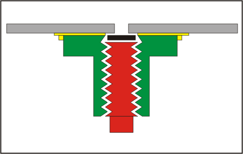

Perhaps a cut-away diagram will help:
The tank wall is shown in grey. The break between the grey sections is the hole through the tank wall. The plug flange is green. The yellow is the solder, bonding the flange to the bottom of the tank. The plug is red. The threads are exaggerated for clarity.
The small black piece above the red plug is the rubber sealing gasket. And as mentioned, the plug threads would be wrapped in teflon.

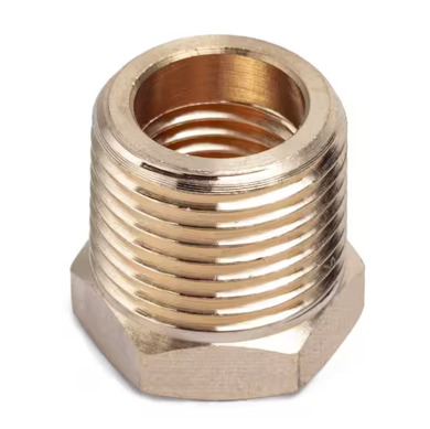

I probably won't use the boat drain plug, but instead this plumbing piece (known as a hex bushing):
I would put the flange on the inside with the bung facing out, then solder it.
Use hardware with pipe threads, no gasket necessary. 1/4 or 3/8" max. You don't want it to drain too fast.

If you have to do this, you would be better off with an o ring seal under the plug head, rather than the rubber pressing against the thin sheet metal of the tank. It will deform and leak for sure, unless you have reinforcement inside the tank.

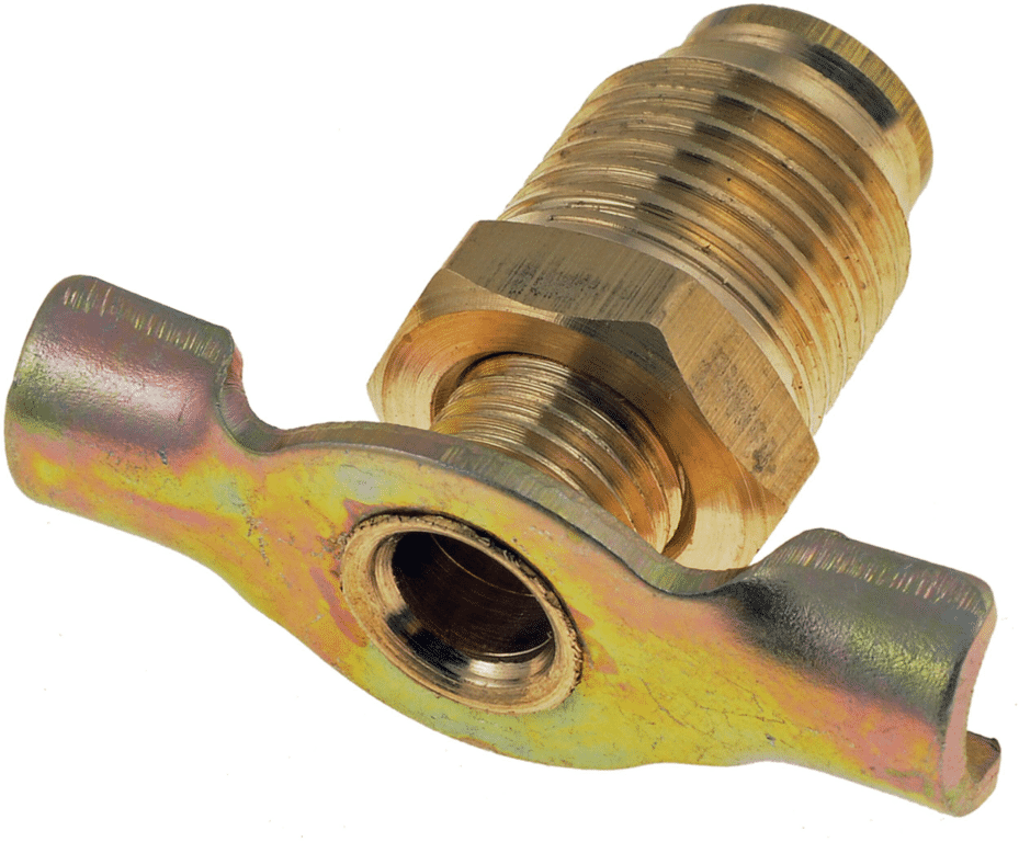

You could have a rad shop install a pet cock valve on a front corner of the tank so its not positioned lower than the tank bottom and susceptible to being hit, like how it is on a radiator. Now you can control the flow and not reinventing the wheel.

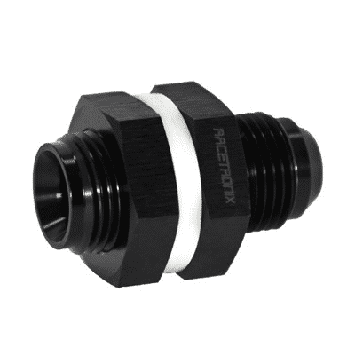

Or one of these would be a good idea, it's designed for this type of usage. (requires a female cap)
JIC is a good-sealing design, and easier to use than the NPTF. No tapered threads to wonder how much tighter you need to make it for it to stop weeping.
With JIC, when the tapered seats bottom out, just a hair more and it's done.
