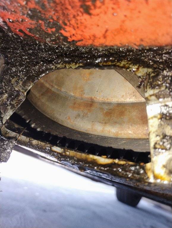

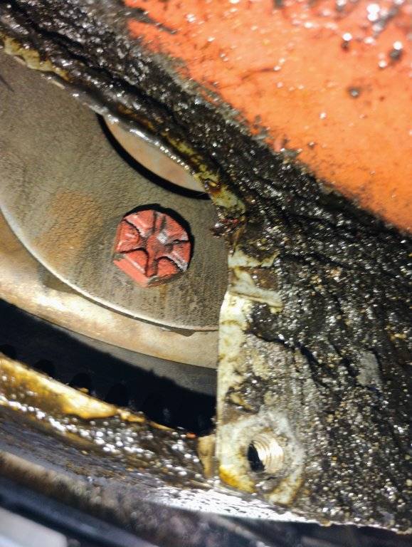

Well I went to drive my car today to see how it was gonna run so I can get new ujoints got 2 min down the road and started make loud metal scraping noise so I pulled over to see if I chucked the drive shaft but it was still there so I idled home because if I go over 5-10mph it makes loud scraping noise. So I got home pulled plate to see if it's torque converter bolts maybe loose and rubbing but they were fine so it seems I blew up my transmission from what I can tell.id post a video of the noise it was making but I can't on here. So I guess I need to rebuild my trans...

Also known as the "sprag". Unfortunately, the more I think about it, the more I'm sure. Pan will have metal debris and hopefully it didn't damage the case to the point of needing replacement.

Yea I'm hoping it's still able to be rebuilt that'd be my plan maybe I'll drop in my 360la at the same time I'm not sure yet. Unfortunately I have to go out of town for work the rest of this month so it's basically gonna sit until then. I'll update when I really dig in to what the issue is.
