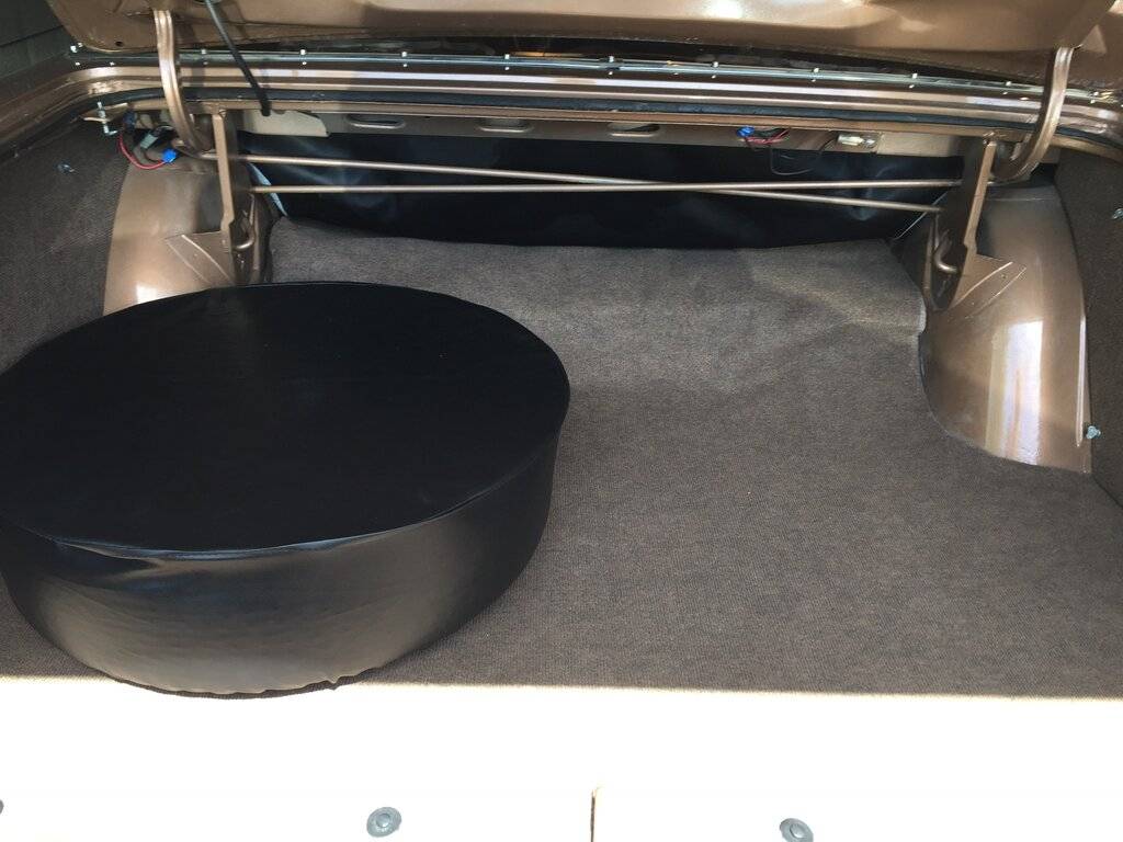

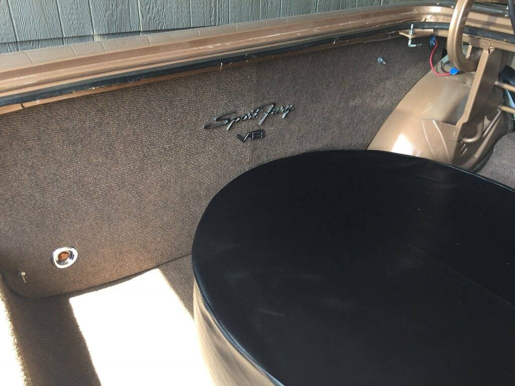

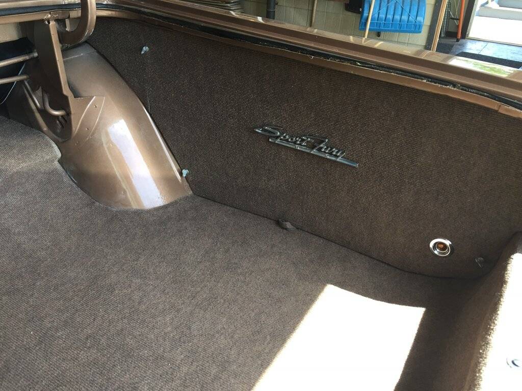

If your not worried about being original make your own. I cut and fitted carpet in mine and for the tire I cut a board to the right size and glued it to a vinyl tire cover. Then I made side covers to protect the quarter panels from getting banged. Works well.

rkrochen: Very nice work. I like the way you put the emblems on the side panels - very classy

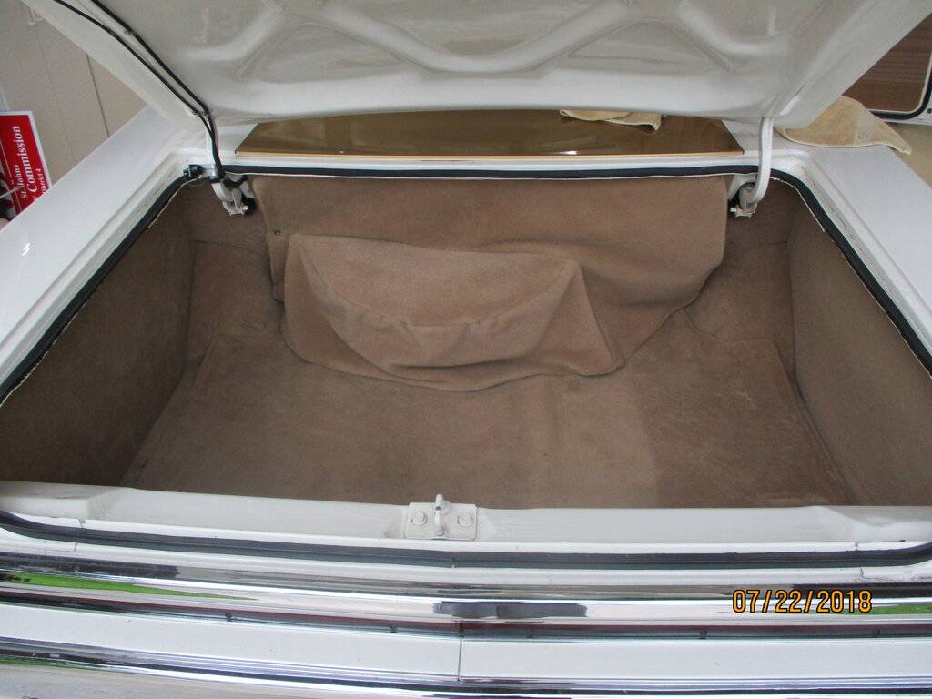

The trunk dress up package is hardly seen and in my experience a uncommon option
I presume the more initial expense of the car the likelihood a buyer would spring for it.
One of my Polaras had it and it was in remarkable condition. Not just a carpet, it had some kind of anti moisture backing on it
