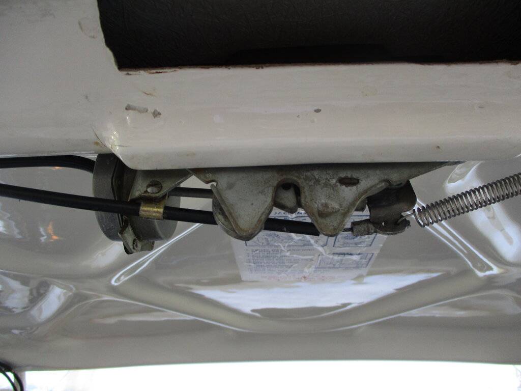

The car has both going to the trunk latch . I haven't tried the vacuum release yet , the button for it I saw in the glovebox .
The cable runs right next to the vacuum line on the left side of the trunk lid . I will have to get a picture of it .

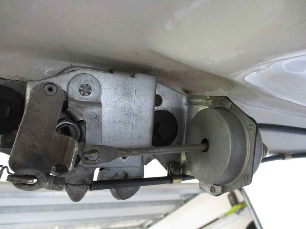

Yes, it has both. Usually the klugey cable works just fine but the vacuum system hasn't worked since 1973.

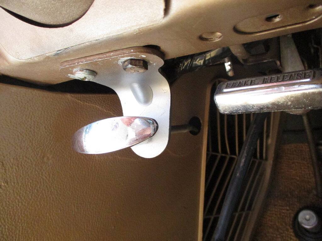

After I overhauled the vacuum side mine works loverly. As for the pushbutton, it is usually the culprit if the lines are fine. Remove glovebox and remove button from car, run soapy water through it while working the button, and/or take it apart and clean it up. Add some dielectric grease to the o-ring seal....works.

I'm going to work on the vacuum side of it and see what happens

Please Forum, correct me if I'm wrong, but didn't all 300s of this period (and maybe others) come with the *luxuuuurious* vacuum release system? But because the Hursts had no keylock due to the swoopy wing, the cable system was kluged into place as an alternative when the engine was off or the vacuum pot had leaked to empty. I'm pretty sure about this because Hurst clearly didn't install the vacuum parts in the glove box, under the right fender, etc. That vacuum stuff is on lots of cars, IIRC.
Gotta love that "custom" cable bracket. So elegant! So classy!! So "hardware store"! :eek:
Nope, neither my coupe or vert had the option. I purchased mine from @Wollfen with the intent of modifying the glove box button to accommodate an electric trunk release. My new mantra has been "visually original", lol.
My car never had the vacuum trunk release. I added an electric release and button from a later Mopar though. Fits and works perfectly and I've integrated the release into my key fob along with aftermarket door locks.

When I bought my car, the vac system didn't work and the cable was questionable most of the time. That's one of the first (of many) refurbishments I did, to get those two things working perfectly.
