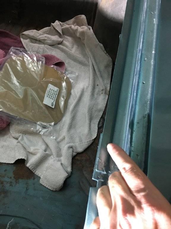

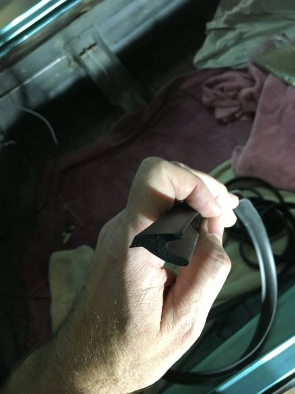

Juat wanted to make sure. The “open” part of the “V” goes outward towards the car body, correct?
Also, just making sure it lays down on top of the raised channel portion (see pic 2).
Third, it goes down in front of the tall section that is above the bumper, or does it stop/start on the sides? (Pic 3)
Lastly, where on the channel do the ends meet (in the middle close to the rear window; in the middle closest to the bumper; on the side, etc)?
Thanks
1 yes
2 yes
3 yes, the notch area on mine had a lead tape type of material on it
4 meets the the lock area
