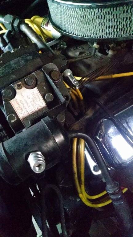

I don't know how different the plumbing is on your car, but here's the RV2 compressor on my '65. The blue hose is the low pressure side. The red hose is the high pressure side.

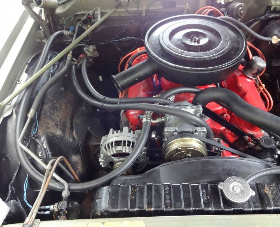

If it's plumbed the way my '69 NY is, the line going FROM your compressor to your condenser (the finned, aluminum part that sits in front of the radiator) will be the high pressure line. The one going TO your compressor from the evaporator (which is inside the car, beneath the dash) will be the low pressure line. You will find 3 Schrader valves in the area of the compressor. Two close to the front and back of the compressor, and one on the head of it, all beneath brass screw caps. In this photo, you will see the new fittings on my converted system. The one more prominent in the photo is where the high side port is, and the one behind the compressor is for the low side. Having said all this, I believe you should do LOTS of homework on exactly how your system is set up. Stan's idea is not a bad one if you're not terribly familiar with these systems. If you do decide to DIY, be careful, deliberate, and do exhaustive research.
You can see the fittings in celticwarloc's pic that are retrofit fittings for R-134A, if you don't have something similar than you probably still have R-12. You DON'T want to mix the 2 refrigerants. If you don't know for sure as was suggested above head for a A/C shop

Any hiccups during the installation?
Pretty straight forward. Everything needed, (except the belts, which only took 5-6 trips to the parts store to get right), came with the kit. The compressor conversion brackets don't allow for exact belt alignment and without completely redesigning them I don't see a way to correct it. Just a minor issue.
The only part I did not replace was the condenser. And it leaked. I pulled one from a 69 Fury my friend in Tenn had, pressure tested OK and is working fine in the Admiral.

Lets just say the brackets are functional. The misalignment is hardly noticeable and the belt stays true in the groove.

There was NO compressor. The original V twin compressor had been removed. I acquired a correct single groove that turned smoothly but was untested, but decided to upgrade to the Sanden type. It's smooth and quiet and RPM drop when engaged is hardly noticeable.
